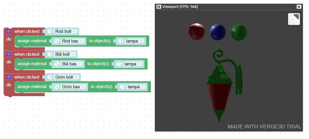

    Im new to both Blender and Verge. Im taking a course in 3D-modelling and this is my first project. Very basic and nothing fancy.
    What im trying to do is a model of a lamp that can change between three different colors by pressing the balls above the lamp. However its only the glas material that changes color and that is the only part of the lamp I need to remain the same. So its not working as intended.
    I got the tip to separate the glas from the lamp by making it its own object. The result is still the same so it didnt work for me.
    The first picture is when I start Verge. It looks great with the glas in the right material.

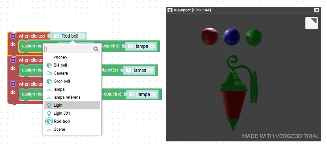

    The second picture is when I pressed the red ball which should change the green color to red.

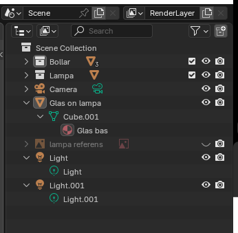

    The third picture is showing the glas material is not available as an object.

    in Blender move the glass material to the bottom. or do not use multi-material objects.
    #80233
    beak
    Thank you for the reply! How do i put the glass on the bottom? I cant drag it further down.
