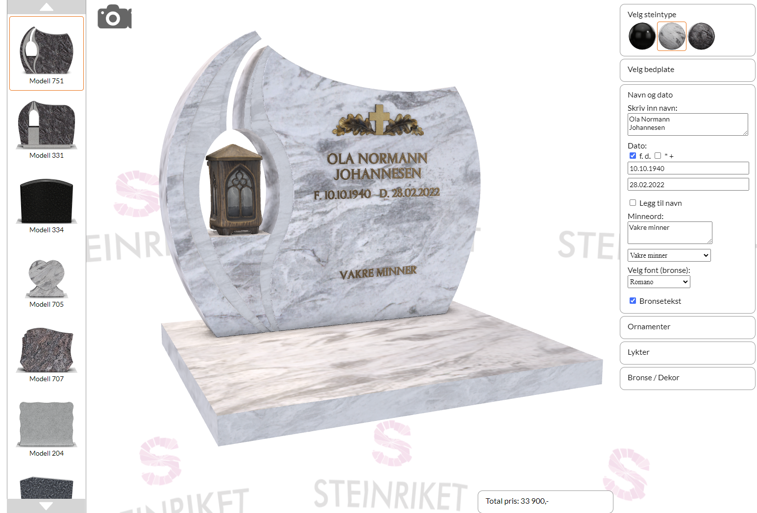

    I’m making a gravestone configurator that shall be integrated into the clients WP site with woocommerse. The configurator will change headstone, add or remove ornaments, and everything has their own SKU. As i understand it the integration for verge3D and “connect to woocommerse puzzle is limited to be used on a product page, while i want to put the configurator in a regular WP-page and access info from many products. It will be several hundreds og unique SKUs.
    I’m in hope to get som help or guidance on how this can be done.
    Here are some ways I see it may work:
    1. Make a “grouped product” in WooCommerse with all the other products and use connect to woocommerse puzzle to build a large dictionary to acces information that way
    2. Make a function that access product, via the SKU number, info with GET commands to the REST API. That would be for each product, and not possible for all at once? And issues with authentication maybe?
    3. Force the client to also put all the products in to the the verge3d plugin database. Not ideal at all.
    Are there any other way that it may be possible to get this to work?
