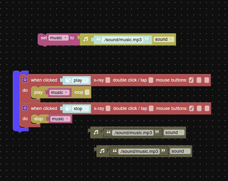

    Is there any browser or internet thing which restricts the playing audio on first click in published scene ?
    On second attempt is plays well… later it plays properly unless you refresh the scene. But once you refresh and load again, the play button needs to be clicked second time to play an audio.
    Can we fix this?

    #80509
    visualizer
    Hi
    KDV
    here is a first set up used straight forward which had to be clicked twice on first attempt to play the sound & later on every first click it will play but the first attempt was required two clicks. first image.
    With the second setup I tried it by setting up the variable first and then it started playing on first attempt of click. as of now it is solved but is this the only way or still there are other ways ? just curious.
    #80514
    that’s the only correct way. sound objects should be preloaded and created before playing them.
