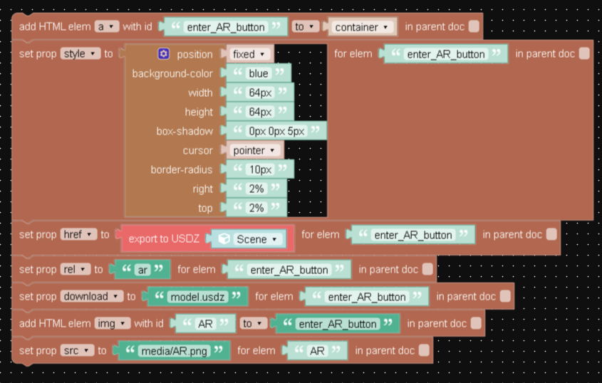

    If I use “puzzle-1” (picture example below). It does export the new material applied to it (which is great).
    But the problem is when I click on the AR button (from my phone) they ask me if I want to download the usdz model, once downloaded, I have to go through the download list and open it from there.

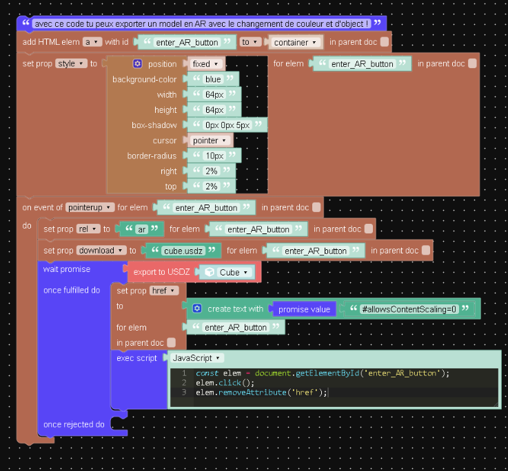

    Compare to “puzzle-2” (picture example below). That if I click on the AR button (from my phone) they ask me if I want to open the 3D file (without having to search it from the download list) which is what I want to achieve. Only problem it doesn’t export the new material applied to it.

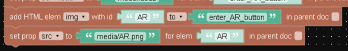

    iPhone need the ‘ img ‘ tag in the ‘ a id=”enter_AR_button” ‘ to be willing to accept it as an AR link
    • This reply was modified 4 months, 2 weeks ago by Pandern.
    #78821
    that’s right. it won’t work as expected without <img> inside <a>. it’s a special feature to initiate AR mode in iOS. along with “rel” attribute set to “ar”.
    #78890
    Nathan Arditti
    It worked thanks guys !
