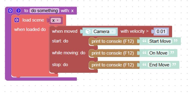

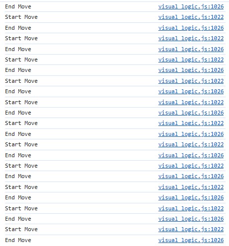

    I use loadscene puzzle to load my scene dynamically with procedure, after that in the “when loaded do”, I put the when moved “camera” do. And what I get is it repeatly running the when start and when end but not runnning the when move.
    ##Remark: problem solved, it is because the when moved event is added second time to the “Camera” object. Just make the “when moved” puzzle run only once is the solution
