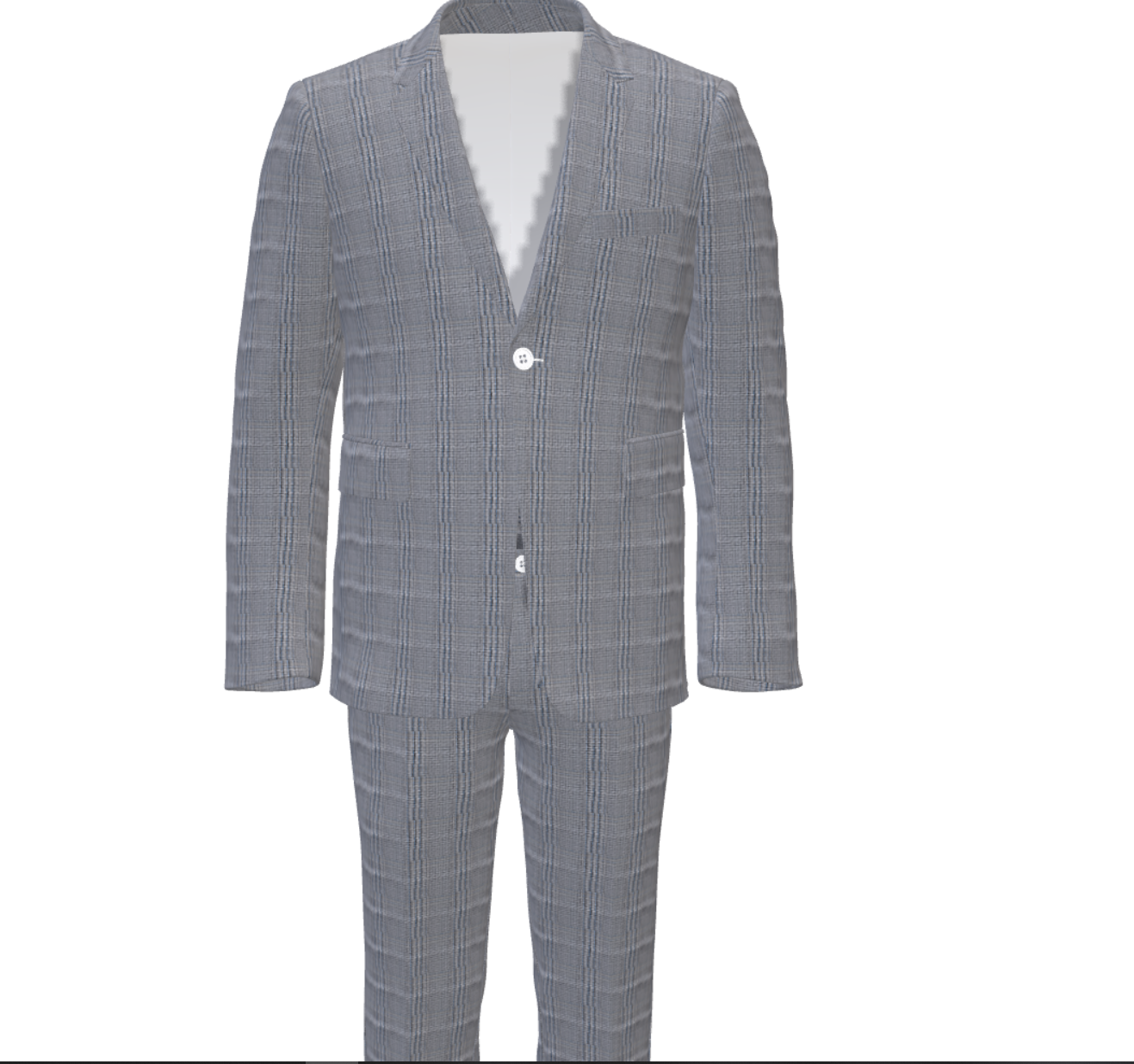

    How do I reduce this weird “warping” effect on Fabric textures in the blender?
    Sneak Peak SS is attached!

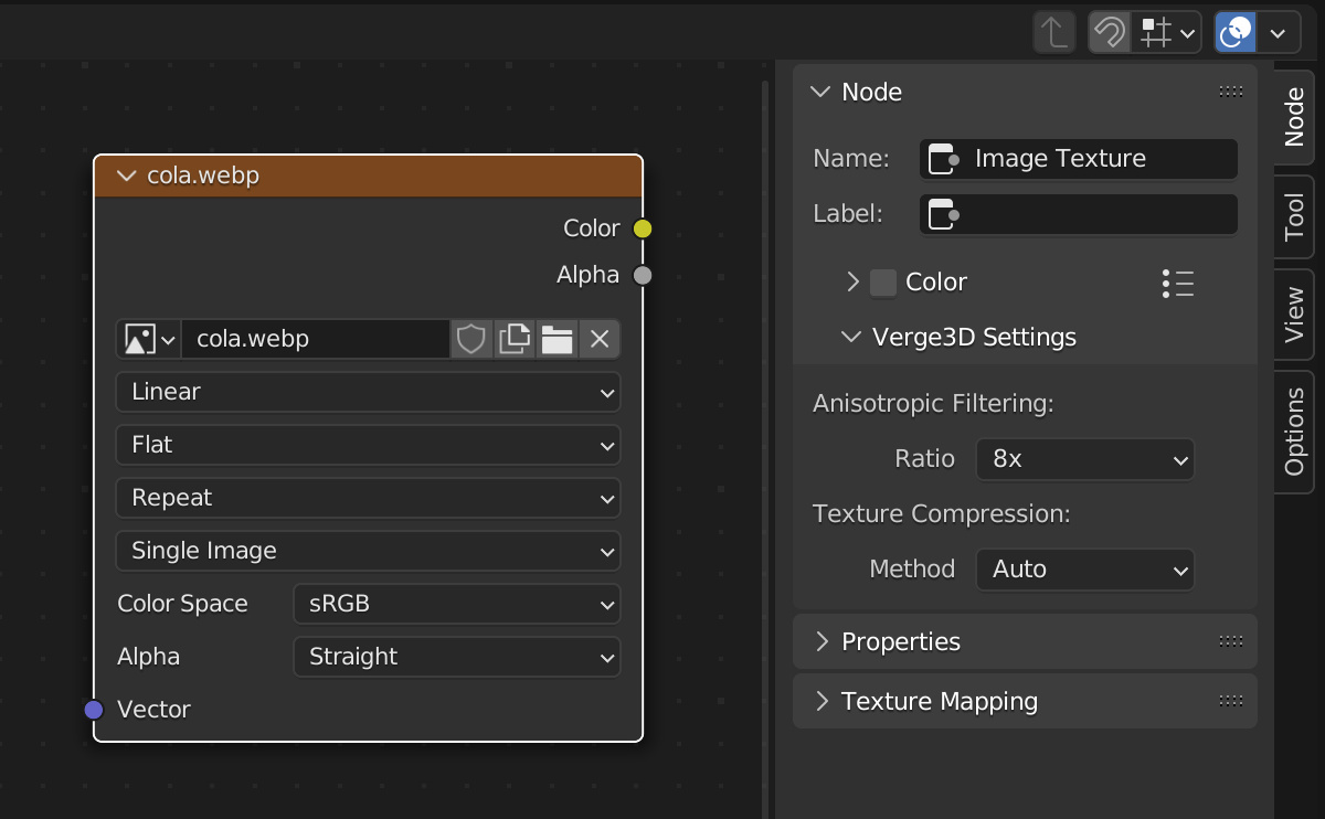

    Hi chaomin,
    you should enable anisotropic filtering on the texture node in your shader.

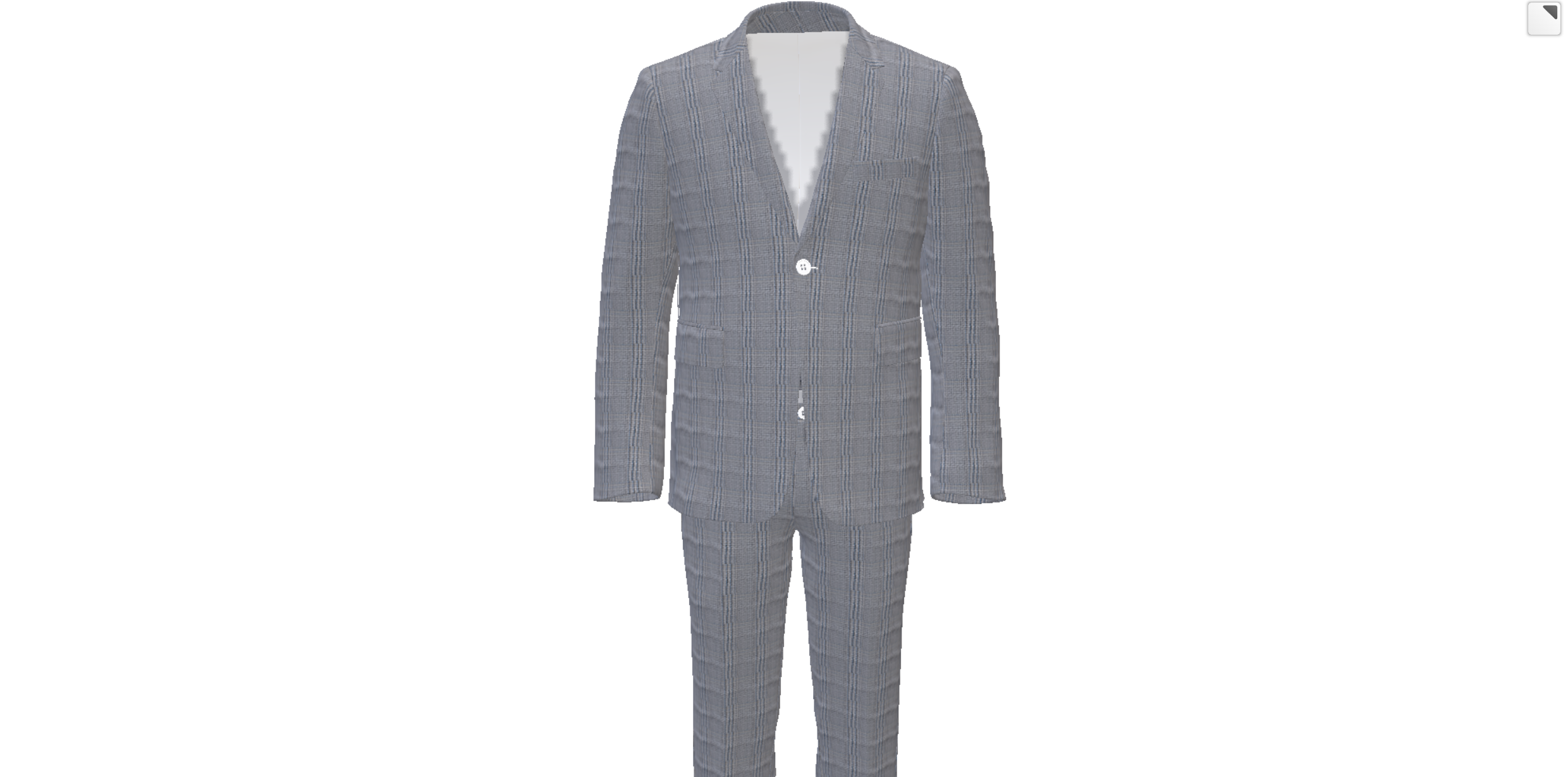

    chaomin
    Can you guide me more about this? It’s still the same.
    #77432
    this option can be set here:

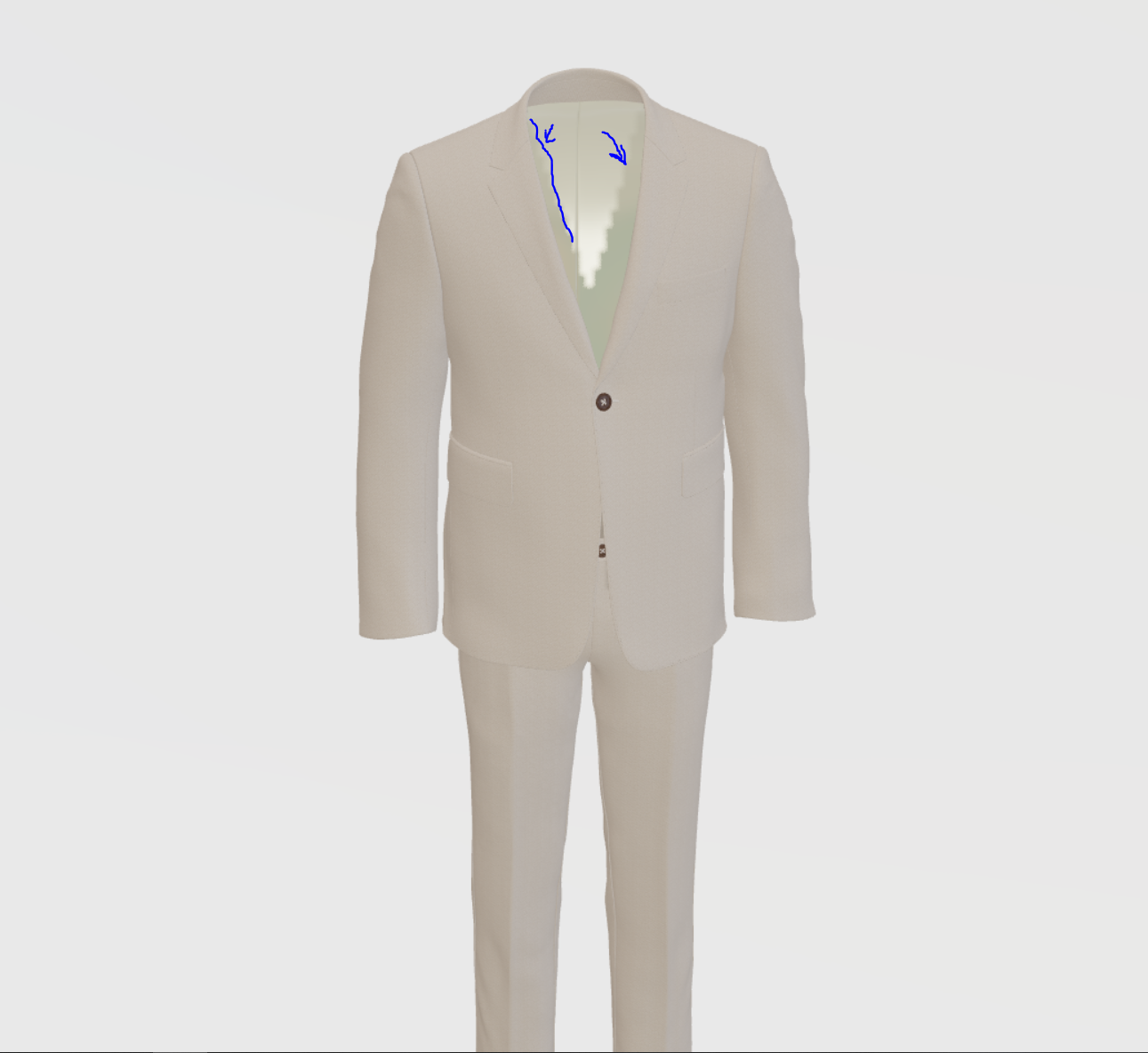

    How can I remove the shadow of light by not decreasing the intensity of light?
    #77516
    Disable shadow recieving for that object in Blender.
