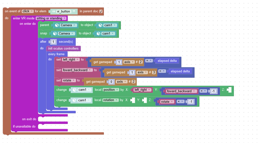

    Regarding the change, yes I can confirm that Puzzles that were VR based in 3.6.0 do not run correctly in 3.6.1
    An example is attached. When this is run on 3.6.1, Firefox/Edge/Chrome all hang in VR. I am using Oculus Quest 2.
