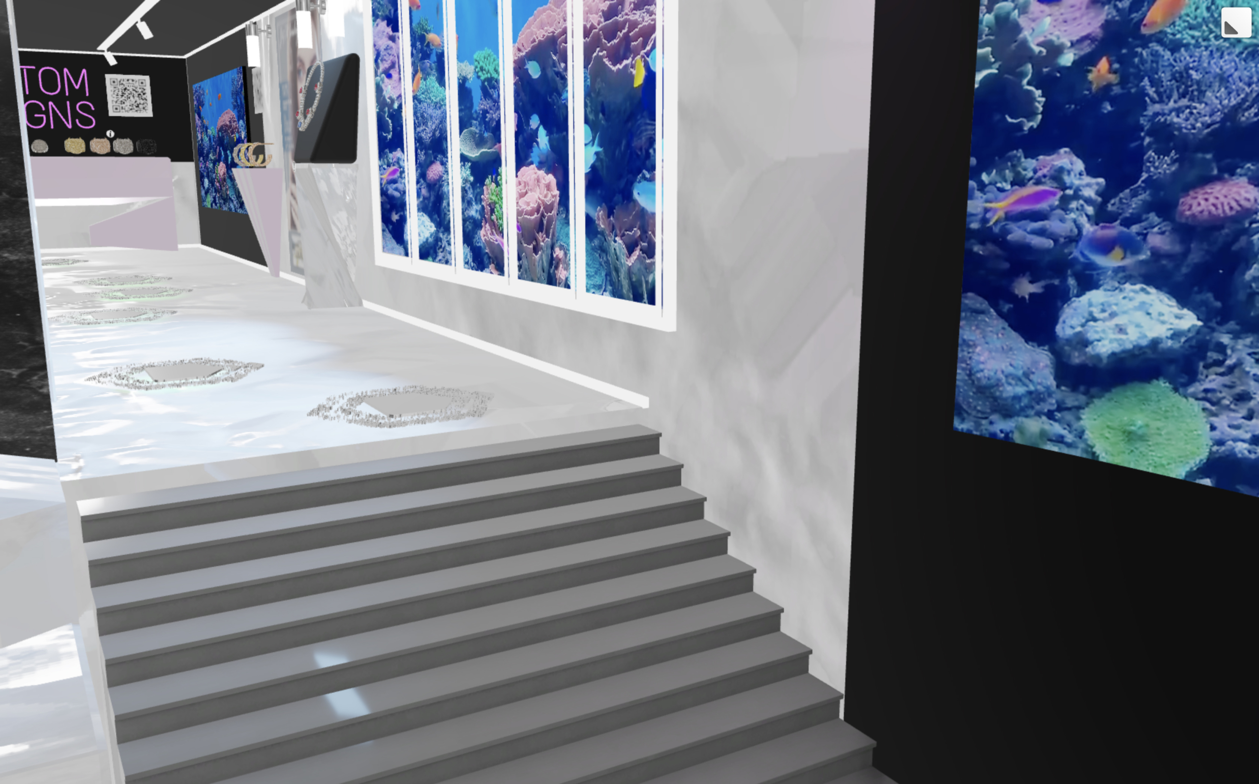

    I am creating a virtual showroom with Blender. I have 5 different video screens in the same scene and currently they are all playing the same video. I have created 5 different puzzles for each one with corresponding url; however, the same video is playing across all of the screens. It appears they are sharing the same source. How can I add video elements to the javascript to play the individual videos in each puzzle? I have attached a screenshot for reference. Would greatly appreciate any assistance with this. Thank you in advance.

    You need to make 5 different materials and assign one unique material to each panel.
    Your material will be updated with puzzle to the cooresponding url for the video.
    5 simultaneous streams will be achievable based on hardware and bandwidth.

    Yes, I have done all that, 5 different materials, 5 different urls, 5 different panels 5 different puzzles blocks and still playing the same video :(

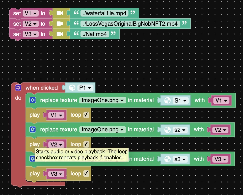

    To test your videos try a simple scene with a few planes. In my case I tried 3.
    I created 3 planes, grabbed 3 videos, and set them to play on the click of the first plane.
    You did mention URLs so…be sure the videos are on the same domain as your app.
    You should also setup a preload of the videos in your Init tab.
    If you need to do it from youtube or a cross domain…you can try this method:
    Youtube video
