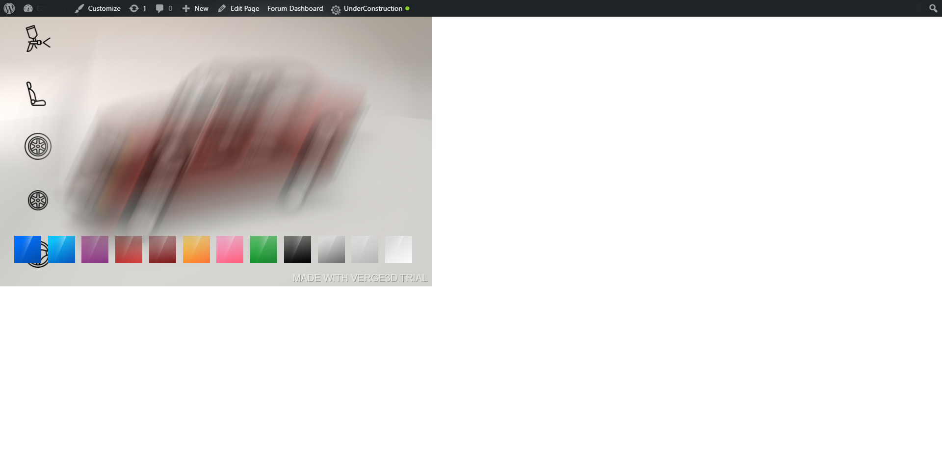

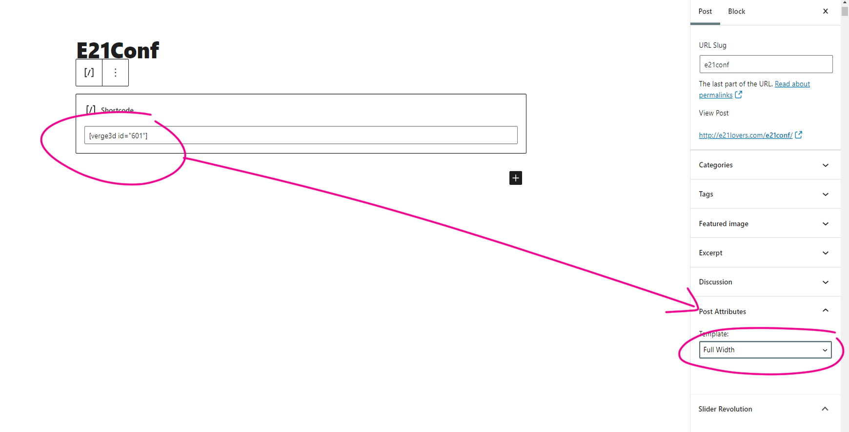

    Hi, i have created a new page and i put shortcode block for configurator, when a select fullwidth the shortcode dont apear in fullscreen, its a configurator and i need it in full screen page, any help please, thank you.

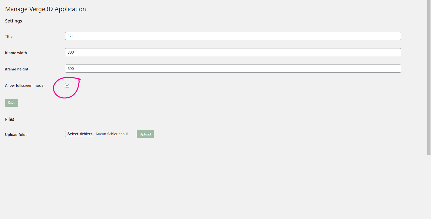

    #41221
    Do you have the “fullscreen” config enabled in the Verge3D app uploaded to WordPress?
    #41241

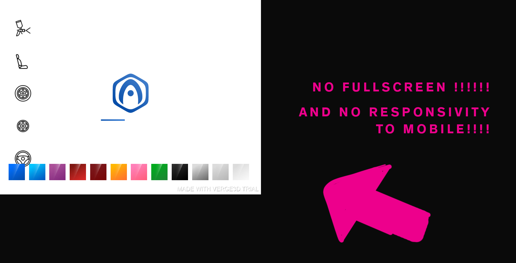

    nabs3d
    Yes sure, this is another 3 shotscreens.

    Hi, that not work ! the tutorials are talking about fullwitdh video or game, but verge 3d works with a Shortcode! the stapes are :
    1 – create 3d model like tutorial
    2 – (Very important) buy Verge3d
    3 – payed for menu in Webflow
    4 – install verge 3d in wordpress were you need to check FULL SCREEN and not work !!!
    5 – Stop the project because Verge 3d not show the result in full screen until to say were you need to put that complicated codes!!!
    Can you create a video tutorial.
