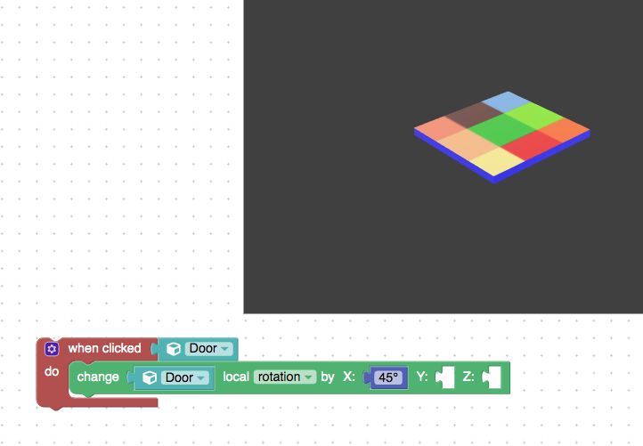

    Hello Verge team,
    This very simple app doesn’t work in my work-environment.
    OS is mac 10.13.6
    Blender is 2.90.1
    Verge is 3.5.pre 3
    https://cdn.soft8soft.com/AROAJSY2GOEHMOFUVPIOE:06b0cc531e/applications/Door_Open_02/Door_Open_02.html
    app is attched
    what’s wrong
    :scratch:
    #35352
    It seems that it works on double click rather than single click. There’s an option to control that. You need to click the puzzle’s cogwheel and enable “advanced event options”, after doing so the “double click/tap” option should appear. I guess it’s enabled for some reason.

    alfred
    Hi Ivan,
    You saved the day, thank you
