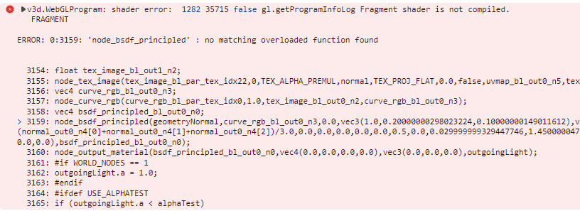

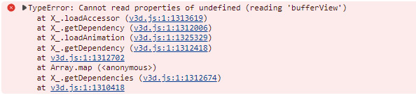

    After following the migration procedure from Verge3D 3.9.1 to 4.6 version, the exported Blender 2.93 models cannot be loaded on Verge3D.
    The browser highlight the errors reported in the attachments.
    Any advice to solve this?
    Thank you.
    #71940
    re-export with 3.6.5+
    #71944
    Yep, 4.6 does not support Blender 2.93 anymore. The minimal version required is 3.0.
