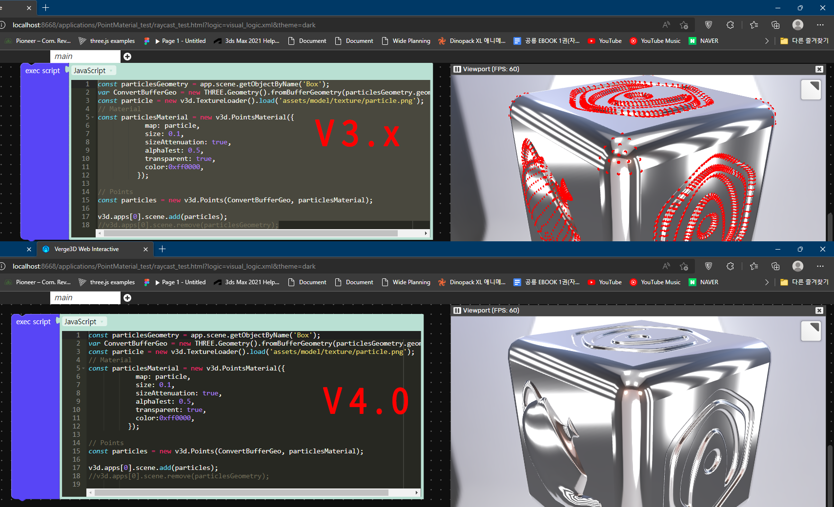

  • #53212
    ppjskk
    const particlesGeometry = app.scene.getObjectByName('Box');
    var ConvertBufferGeo = new THREE.Geometry().fromBufferGeometry(particlesGeometry.geometry);
    const particle = new v3d.TextureLoader().load('assets/model/texture/particle.png');
    // Material
    const particlesMaterial = new v3d.PointsMaterial({
                map: particle,
                sizeAttenuation: true,
                alphaTest: 0.5,
                transparent: true,
                color:0xff0000,
    // Points
    const particles = new v3d.Points(ConvertBufferGeo, particlesMaterial);
    v3d.apps[0].scene.add(particles);
    //v3d.apps[0].scene.remove(particlesGeometry);
    same code not working v4.0
    #53215
    Geometry class is no longer available in Verge3D (same with Three.js). Use BufferGeometry instead. See an example here.
    #53218
    ppjskk
    Thank you!
