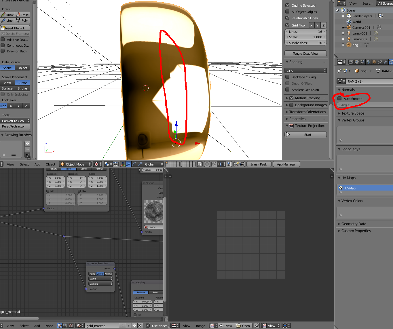

    Hi. I noticed artifacts on the UV when I export the scene.
    its a blender result. (without splice)
    https://b.radikal.ru/b37/1802/34/3b39e018017b.jpg
    its a browser result. (with artifacts)
    https://radikal.ru/lfp/b.radikal.ru/b41/1802/7d/17dc306d1212.jpg
    How can I fix this ? Thanks.

    If you’ll uncheck Auto-smooth on mesh you will see the same result in blender. Because Autosmooth (custom vertex normals) is not supported yet (we are working on it now) when you export this mesh to the engine it exported without auto-smooth option. For now you need just to uncheck it and remove double vertexes to get smooth result on this object.
