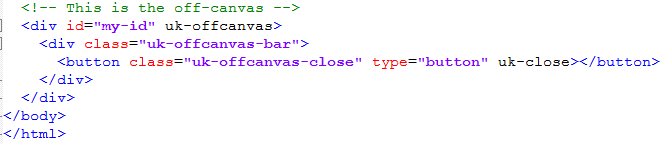

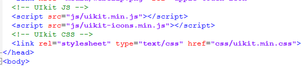

    my_app.js
    puzzles
    index.html
    the side-bar <div> is also in index.html

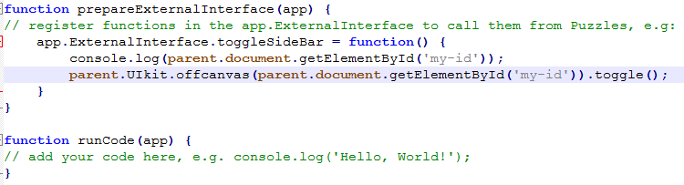

    #54693
    Aubrey
    Brilliant! :yahoo:
    It was the ‘parent’ in the js that I needed.
