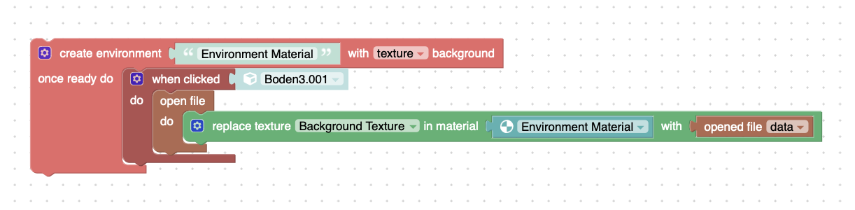

    Is it possible to upload images as hdri background by using this puzzle? I tried it together with the “create Environment” puzzle? I tried but can’t figure out how to do it. Screenshot attached.
    (If not, could I change the material of a skydome like this?)
    #69146
    Your logic is quite correct but sadly this won’t work with .hdr files. The replace texture and open file puzzles need to be modified to do the job.
    #69147
    alissa
    Oh ok. But isn’t the “create environment” puzzle for changing the environment material? That’s the way I understood it from reading the manual here: https://www.soft8soft.com/docs/manual/en/puzzles/Scenes.html#create_environment
    #69149
    It’s not for changing, it’s for creating in case you didn’t create the world material in Blender. In general this puzzle is not needed at all.
