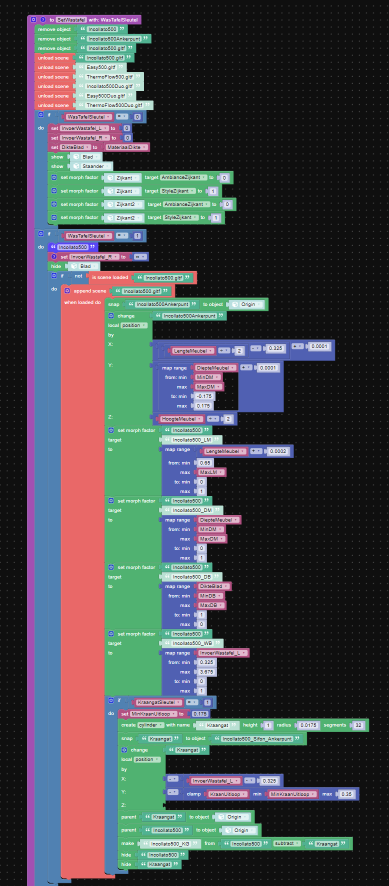

    Hello All,
    I am making a (quite complex) configurator with multiple options for washbasins. To change the washbasin I use the “Append to Scene” puzzle. which works fine for the first basin but now I want to choose another basin. I use the “Unload Scene” puzzle for the previousely loaded scene but it doesnt work. The new basin is loaded with fine but the old one is stil in the main scene.
    (remove object, Hide object both wont work either)
    Thank you
    #75726
    these two objects already do not belong to the unloaded scene
    #75730
    martenmonoz
    Thanks kdv!! I made a new object from the original by suctracting a third object. I thought the new object would be in the same scene but it is not. Solution is to first remove the newly created object and then unload the scene.
