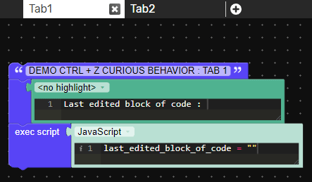

    Hello, i spotted a strange and very annoying bug while coding with your puzzles :
    When you use “blocks” such as the “multi line text” or the “exec script” puzzle, if you write something down , save, then go to an other tab, do something and CTRL+Z it, it will also undo the thing you wrote down earlier in your first tab.
    This is pretty bad actually because it always breaks my codes everytime. I’m affraid of using CTRL + Z now that i figured out this was the reason of most of my struggles.
    I attached a gif to this message to show you what is really happening.

    Hi, thanks for the GIF, we’ll surely check it out.
    #63633
    Hi matgall,
    That was a bug in Verge3D 4.2.0, but it should be already fixed in 4.3.1. Can you try the latest version and check if it works for you?
