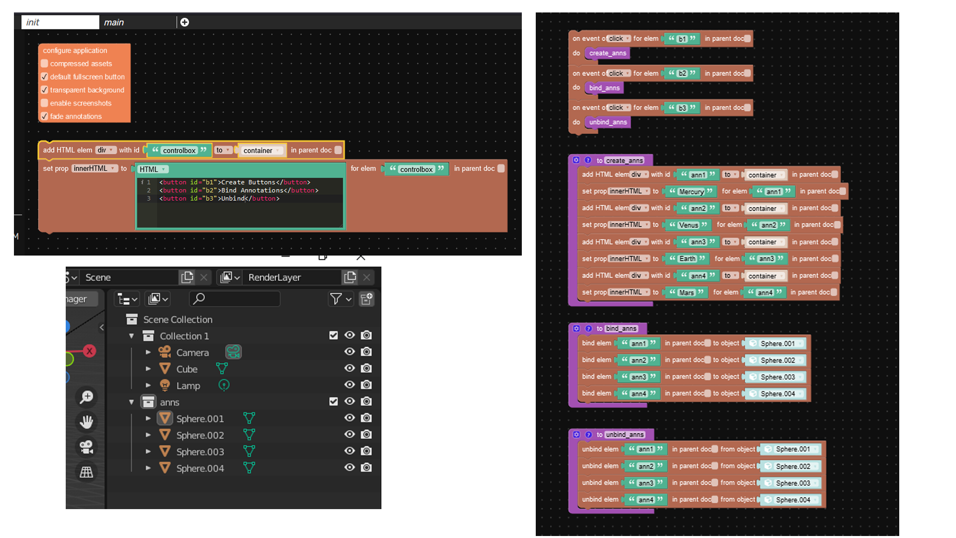

    Ok, pulling my hair out here. What am I doing wrong?
    Here is the demo.
    https://v3d.net/9o5
    First button creates custom divs (annotations) , second button binds them objects. The third is suppose to unbind them. No joy.. If you run it 3 times, it finally gets rid of all bindings.. but that’s not how its suppose to work. Bug or user error?
    I’ve attached the code and a zip of verge app files
    Help please, thanks!
    And how that’s supposed to work? Is that supposed to jump back to the initial position or you just want to unbind them all at the same time?

    Bug or user error?
    Find appInstance.renderCallbacks.splice(i, 1); in puzzles.min.js and add _pGlob.bindHTMLCallbackInfo.splice(i, 1); above. Save.
    The result should look like this
    Then open the app’s puzzles and save them to update visual_logic.js.
