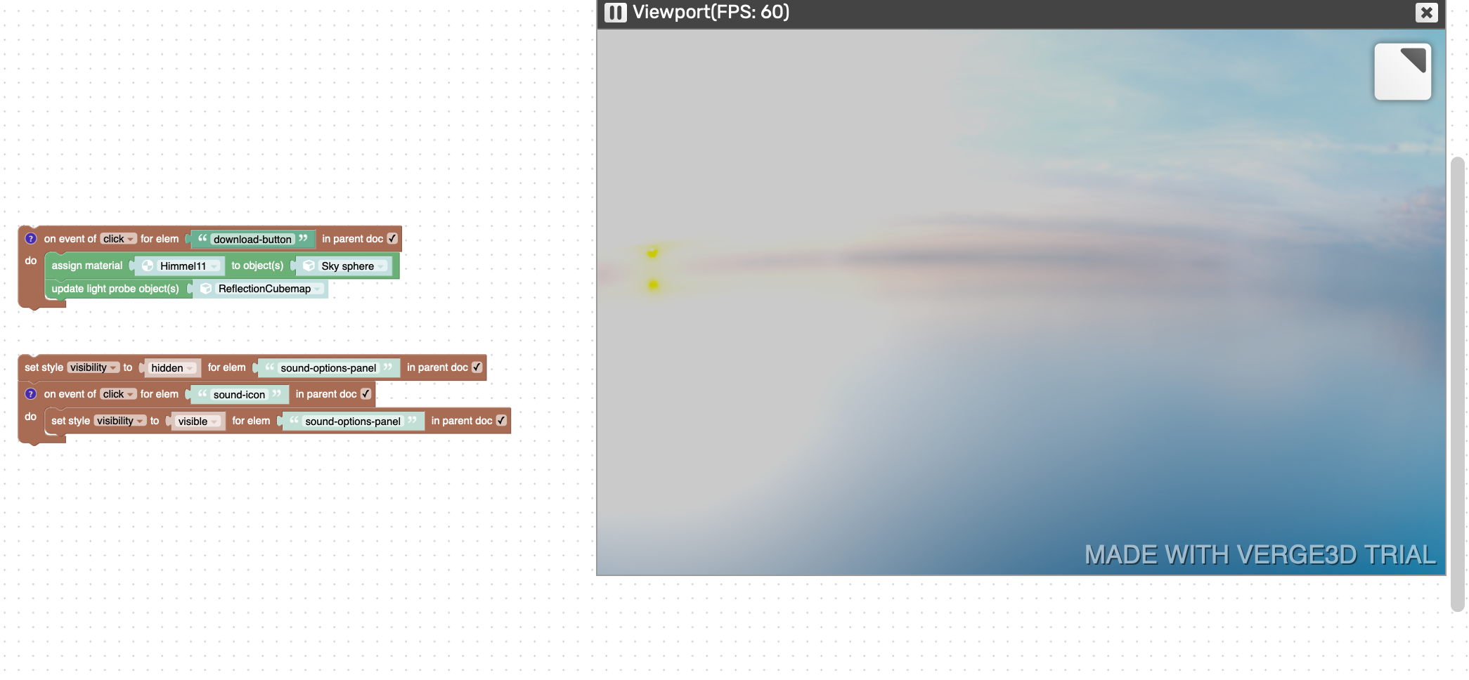

    I created an interface on Webflow but I can not interact with the buttons through puzzles. All of my UI elements have IDs and I can see them when I run my app. Although they are not visible in my viewport next to the puzzles. Am I missing something to interact with them through puzzles? I have some pictures attached.

    watch this tutorial

    #69279
    watch part 5 from ~3:00
    it and I can’t find my mistake.
    You didn’t embed the Verge3D html page into the Webflow html page.

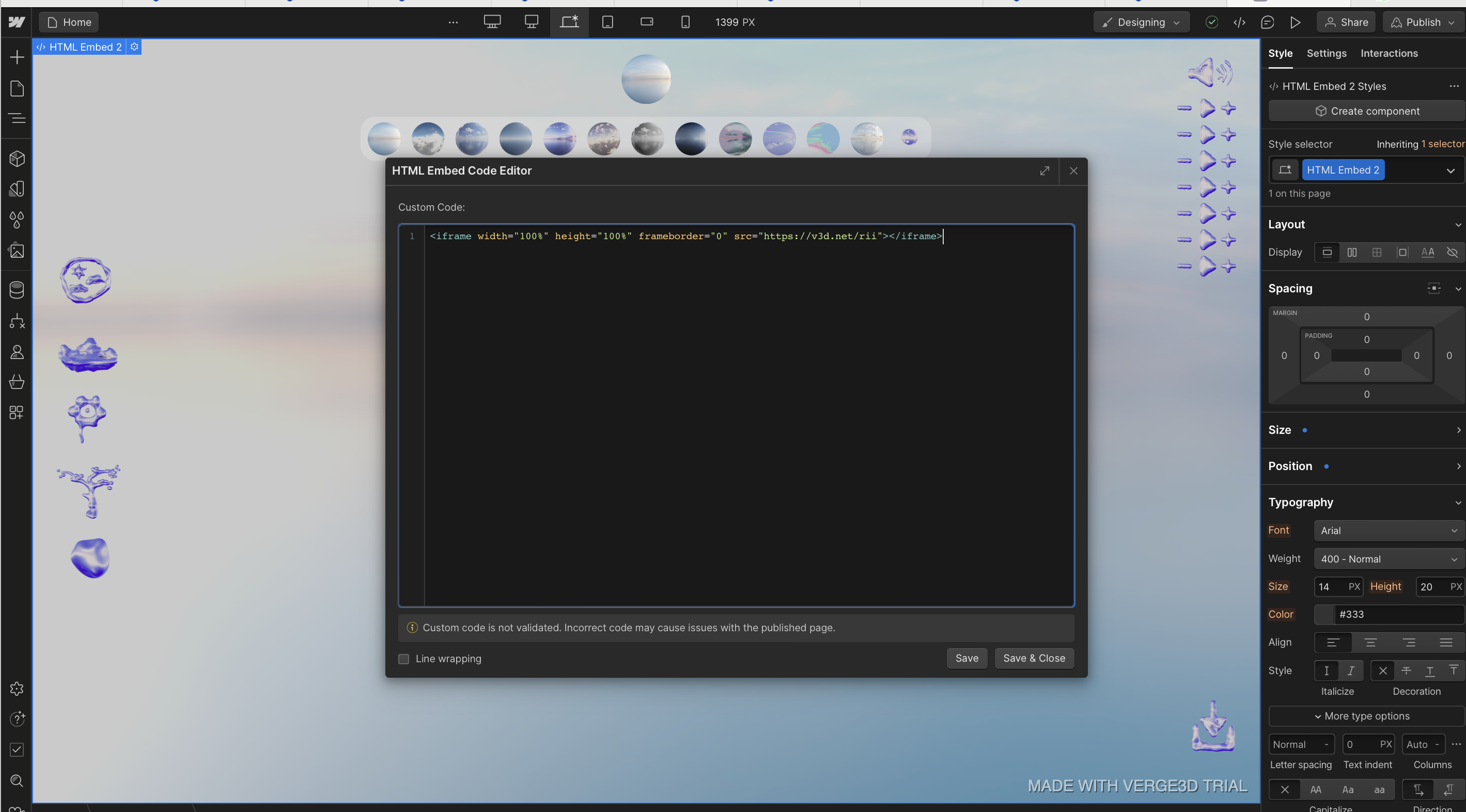

    alissa
