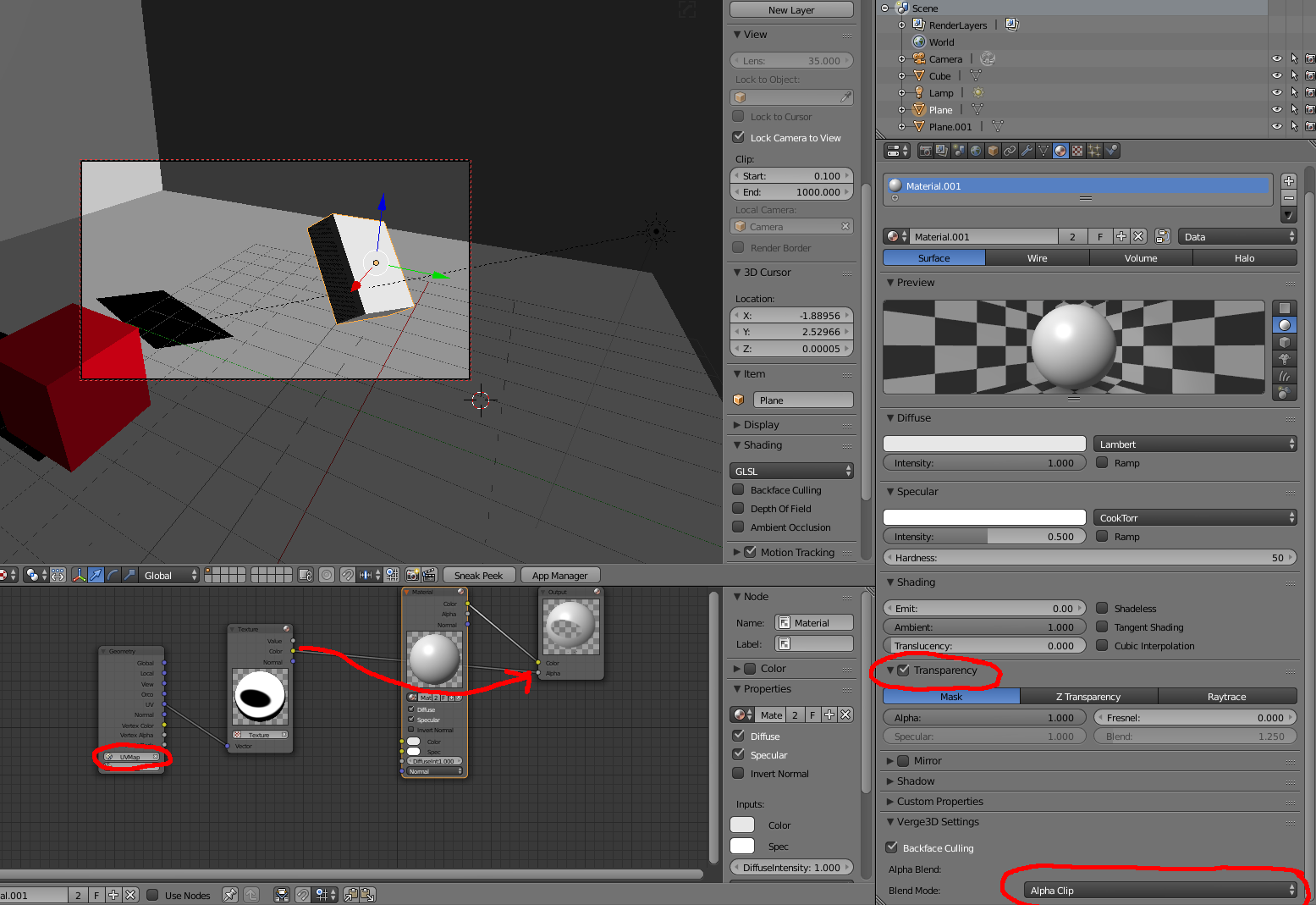

    I created a quick test scene, that looks like this in Blender:
    And here in my webbrowser through Verge3D:
    The transparent texture is not showing up. How can I get transparent textures to work?

    Hi, you need to set a few checkboxes befor. Set Transparency checkbox, then in Verge3D section choose right transparency type Blend, Add etc. Then connect your Texture to alpha input in the Output node (for now Alpha Texture supported only in node material).
