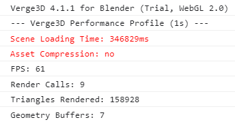

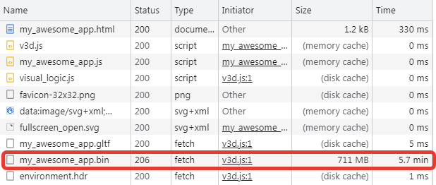

    Your app is loading tooooooooooo long. Too many bones and bone bindings, over 2000…
