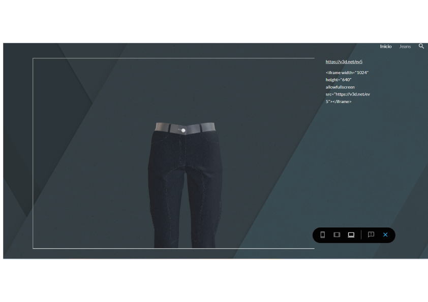

    Hello, everyone, Im trying a transparent background with the puzzles, however when i insert the html into another server, although it is transparent, I get this grey frame around it.
    Any idea what it might be? :unsure:
    #60193
    Looks like the iframe borders. Add frameborder="0" inside the <iframe> tag.
    Btw, visual_logic.js won’t work with the used iframe src if you try to access elements (buttons/selectors) in the parent document…
