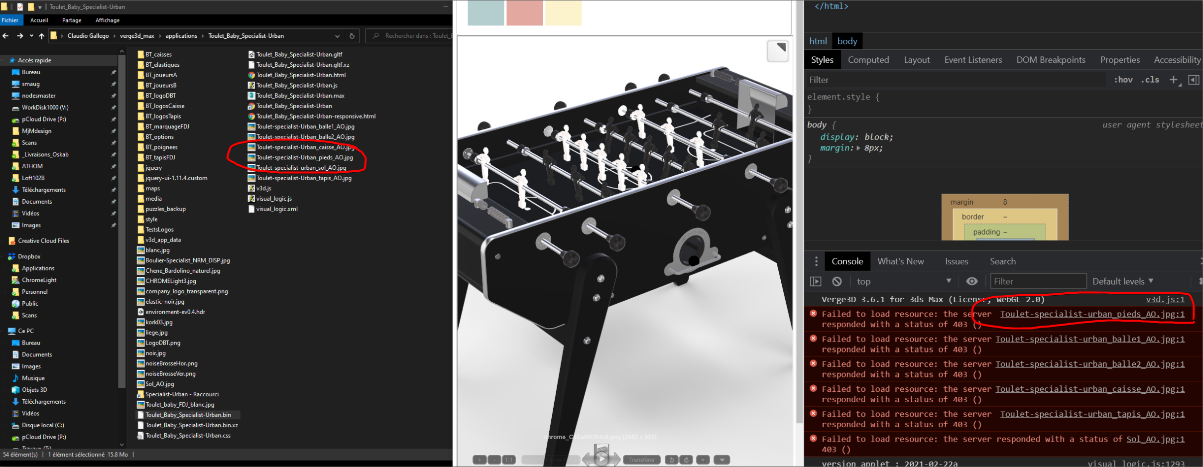

I have a strange behavior here :
I’ve made one table soccer configurator, and it works (not nice for now, still need to render AOs)
https://cdn.soft8soft.com/AROAJSY2GOEHMOFUVPIOE:5c0bd316e1/applications/Toulet_Baby_Specialist-New/Toulet_Baby_Specialist-New-responsive.html
Then i’ve then made a second project, almost identical, the “local” version is working nice, but when i upload to verge3D cloud, it can’t find maps :
https://cdn.soft8soft.com/AROAJSY2GOEHMOFUVPIOE:5c0bd316e1/applications/Toulet_Baby_Specialist-Urban/Toulet_Baby_Specialist-Urban-responsive.html
It should start white, and the wood choice should work, among other ones.
Both puzzles are the same concerning “caisse”, and puzzles are looking for “./maps/colorXXX.jpg” in both projects.
I’m really stuck here.
