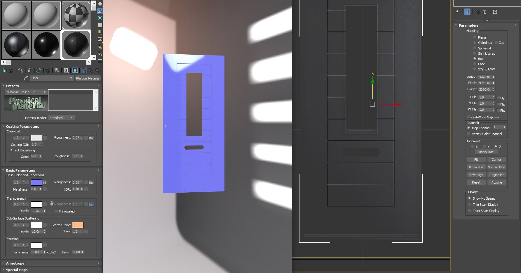

    This issue came out of nowhere, this project was done 6 months ago with a previous version, everything was fine. After I’ve recompiled in the new version, I am missing textures! I have tried everything, everything was working before, there are 4 textures within the project. Any ideas? Is this a bug?

    MAX2018, latest V3D
