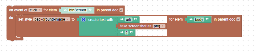

    So, I was testing how to take a screenshot. The user manual delivers a pre-made puzzle-solution I reproduced.
    I re-created it using the data seen in the attached picture.
    Thing is: nothing happens. I debugged the HTML-button and it is working.
    Where am I going wrong.
    Any help appreciated.

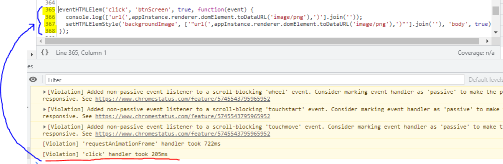

    print to the browser console the create text with puzzle and compare the result with what you’re expecting to get )))

    gdoes
    Thanks for getting back to me.
    The image attached shows you what I get from the debugging-console.
    However I have no clue of what is expected in this case.
    I am a designer first and foremost, I have zero knowledge about debugging processes or making sense of the code generated by any puzzle.

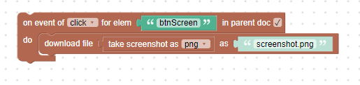

    ===== Solved =====
    I had to do some digging and eventually found a solution.
    Turns out the documentation is either outdated or pointing to some other overly-complicated solution.
    It’s enough to use the “download file…” puzzle with “take screenshot as…” puzzle as it’s first entry.

    #53445
    you wanted to get a screenshot and dowload it? not an url? then yes, you’ve found the right solution )))
