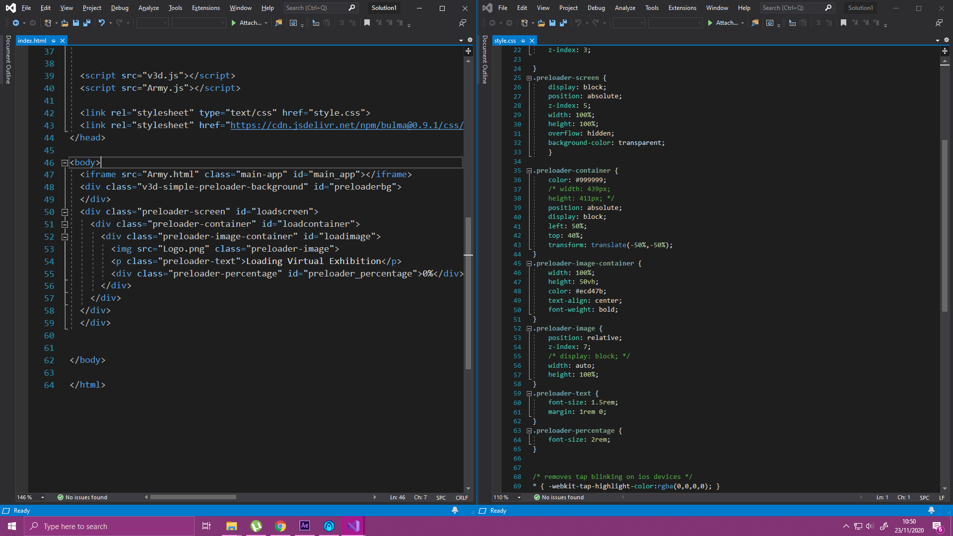

    Hello all, so I need to create custom preloader and use jewelry sample and verge documentation about stylizing the verge as reference. it’s applied to the preloader but, it stuck and won’t progress to the 3d scene, any idea maybe what’s wrong with my code?

    ok NVM already found how to fix it.
    first of all there’s “faulty” in the main html which there’s loading BG there so instead load the scene it’s load BG instead.
    secondly if the puzzle won’t appear maybe you deleted this
    <!– __V3D_PUZZLES__ – enable Puzzles button in the App Manager –>
    on the main html
