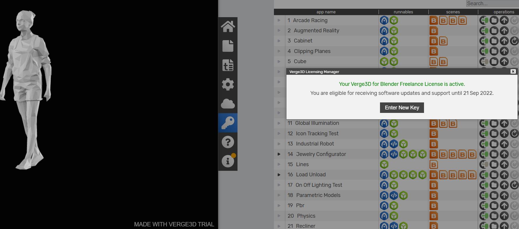

    HI,
    First, I’m trying to update to ver4.0 from ver3.9 but after I installed the 4.0 .exe, the version shown at the app manager was still shown as 3.9…so I tried to delete the addon(3.9 one) which installed in Blender and do a new installation of 4.0 but it still didn’t work….besides, I try to open the old version of Blender to see if the ver3.9 of Verge is still there, it was there!! but when I check with the app manager button, the “MADE WITH VERGE3D TRIAL” massages came to my eyes…what should I do now….??
    Please tell me if any informations you needs.
    Thanks!!
    #54165
    click update buttons. they should be grey-faded. if they are black v3d.js in ..\Verge3D\build\ and in the app folder are different…
    or copy v3d.js from ..\Verge3D\build\ to the folders with your apps manually…

    #71931
    Please follow 4.0 migration guide, there might be some issue with incorrectly assigned application folder. Also, I would suggest using more recent version of Verge3D :-)
