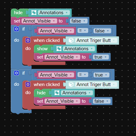

    I created a collection of 3D objects in Blender3D and called it “Annotations”. And created a button (3D, not HTML) to toggle the show/hide status of the above-mentioned collection.
    When the webpage loads, I want the collection “Annotations” to be hidden and when clicked the “Annot Triger Butt”, I want the collection to be visible. And when clicked again, I want it to be hidden again.
    I did the puzzles as below, but not working. What is wrong with my puzzles and how to do this properly.?
    Thanks in advance.
    put your condition inside the when clicked puzzle

    #59417
    albi
    Yes, this worked. Thanks very much. :good:

    albi
    Yes, this worked. Thanks very much.! :good:
