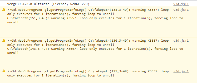

    If a mesh has only one shape key (Basis + Key 1), v3d engine finds errors in shaders and shows these warnings.
    But if a mesh has two or more shape keys then it’s OK. no errors, no warnings
    #59114
    This warning indicates that a loop contains only 1 iteration. It’s a perfectly valid thing. No idea why such a warning is issued at all. :unsure:
    #59115
    BTW if these messages bother you, you can disable them by calling this code before loading a scene:
    v3d.apps[0].renderer.debug.checkShaderErrors = false;
    #59116
    yeap, these warnings really annoy me ))) the console log must be clear showing the v3d version only ))) I’ve just added the second shape key to get rid of them. Profit: I know the cause now…
