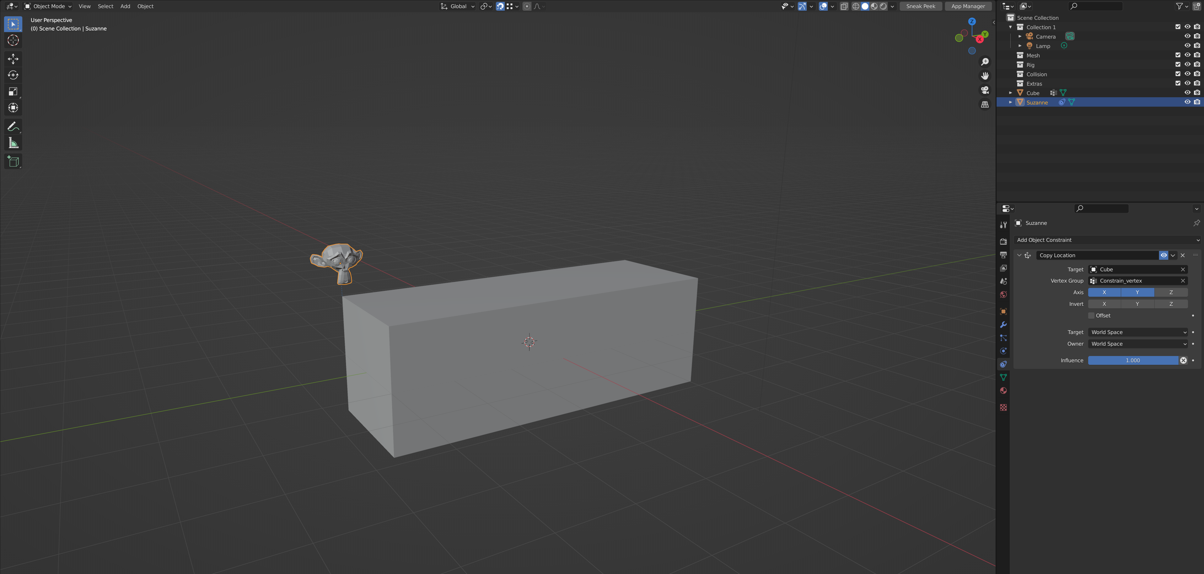

    I got some problems with constraints. In blender everything works fine, but in Verge3D the constraints won’t work and some settings are ignored.
    I attach a screenshot of a example. The box can be scaled on the y-axis via a shape key and a single vertex is assigned to a vertex group which is set for the copy location constraint on the monkey head. However the monkey head in Verge3D just gets placed at the origin of the box and doesn’t move with the box.
    Is this a bug, or I’m doing something wrong?

    Vertex Group of Copy Location constraint not supported.

    Thanks for the response. Do you have a solution to accomplish the functionality of an object moving with the shape of an different object?

    You can use puzzles to combine changing of shapekeys and moving of other object with specific formula.

    Hi Mikhail, I don’t understand what you mean to achieve this. I have tried the ‘Snap object to object’ item in the puzzle creator but that doesn’t let me define vertex groups.
    Really need a solution for copying location to a specific vertex group in verge3d. I already have it working in Blender.
    Let me know, thanks.
    #52543
    I mean you can convert state of the shapekey to an object position, but there’s no possible to get position of vertex for now.
