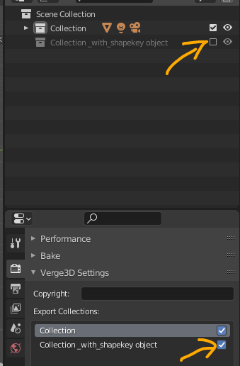

    i found an interesting bug in verge3d 3.6.1 on blender 2.92:
    when exporting a collection, which is not currently enabled in blender, but enabled in the verge3d export settings, the shape keys of objects inside that collection will not export correctly.
    this is quite a rare case, but i came across it, and needed some time to find the cause.

    thomasup
    this seems to be generally true for objects that are not visible in the viewport.
    only objects, that are visible in the viewport export correct shapekeys.
