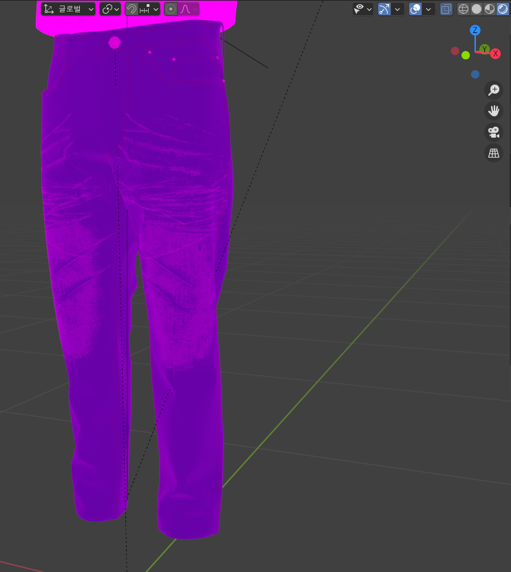

    In the material state, the original color comes out, and in the rendered state, the object appears purple. What’s the problem? Objects are gltf files

    This mean that something lost in this material: textures or output. Can you share a screenshot of the material?

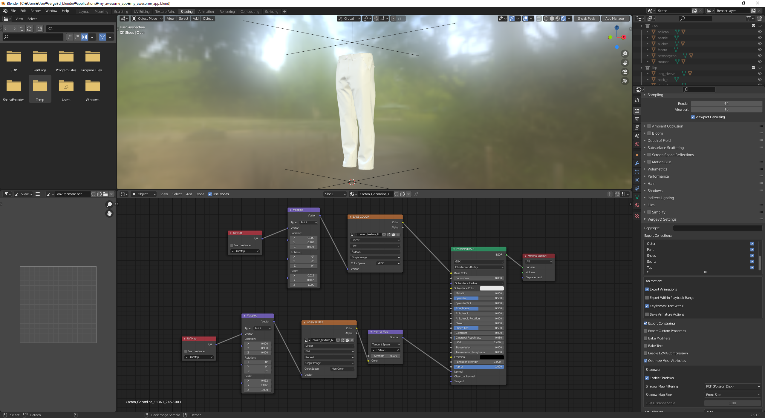

    There is one thing I doubt. If it doesn’t work, I’ll tell you.

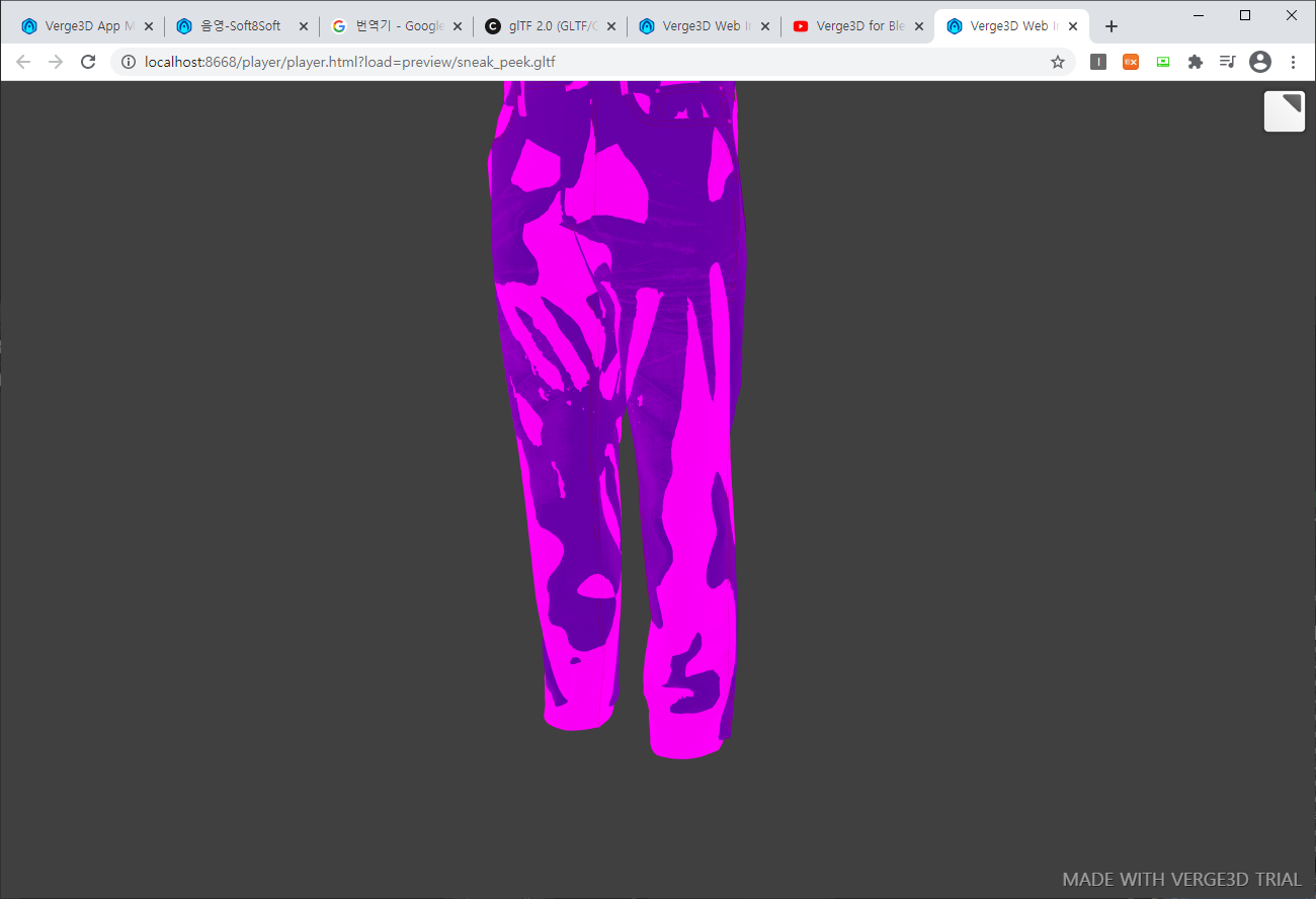

    1.sneak peek screen
    White has 2 pants
    2.blender 3d
    #36811
    Seems like hdri lost and when you exported some other objects was unhided. You need to unset render icon for all other object except one you want to test and check your hdri texture, bay be it’s broken. Try to use one of that included in all our demos for test.
