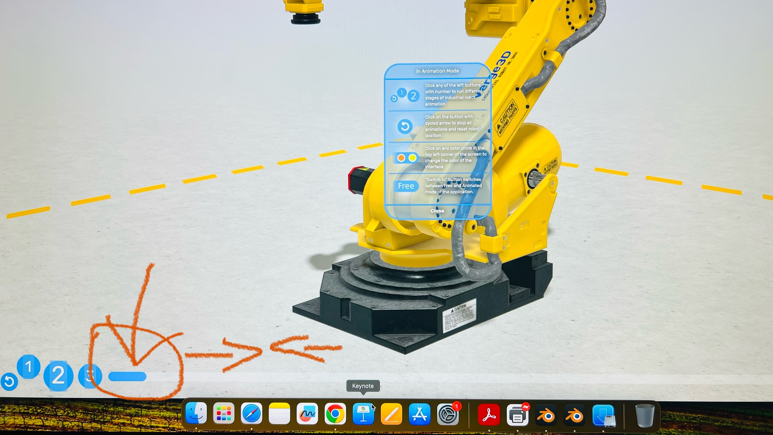

    Hi Dear Community,
    My desire is to implement the scroll bar for all animations. I wonder if my solution could be this time bar ( on attached screengrab)that potentially could be modified to an interactive scroll bar?
    Do you know how I can modify it?

    #77758
    David Duperron
    Hi @Iren!
    In the provided example (industrial robot) the scrollbar is a HTML element (ID = anim_navig_indicator), and its “left” style attribute is controlled every frame by the animation frame. See the puzzles below:
    Animation puzzles
    You could also use a HTML range input in your interface, and use the “input.value” to link it the the animation frame (for example you add an input event puzzle, attached to this range input, and you add an animation puzzle in the “do” slot to go to the desired frame of the animation.
    Input puzzle
