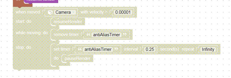

    I recently was asked to update an older project into the latest version of Verge3D, and I found a couple of problems. One was fairly simple, I just had to remove the “read JSON from” puzzle in a couple of spots. But another has me stumped. When I changed the visibility of some items, it doesn’t change on screen until I move the camera. It worked correctly before.
    The simplest way is disabling this puzzle
    Looks like after updating a lot of functions are not in use and you’ve lost all functions in prepareExternalInterface(app) inside salamander_cabinets.js
