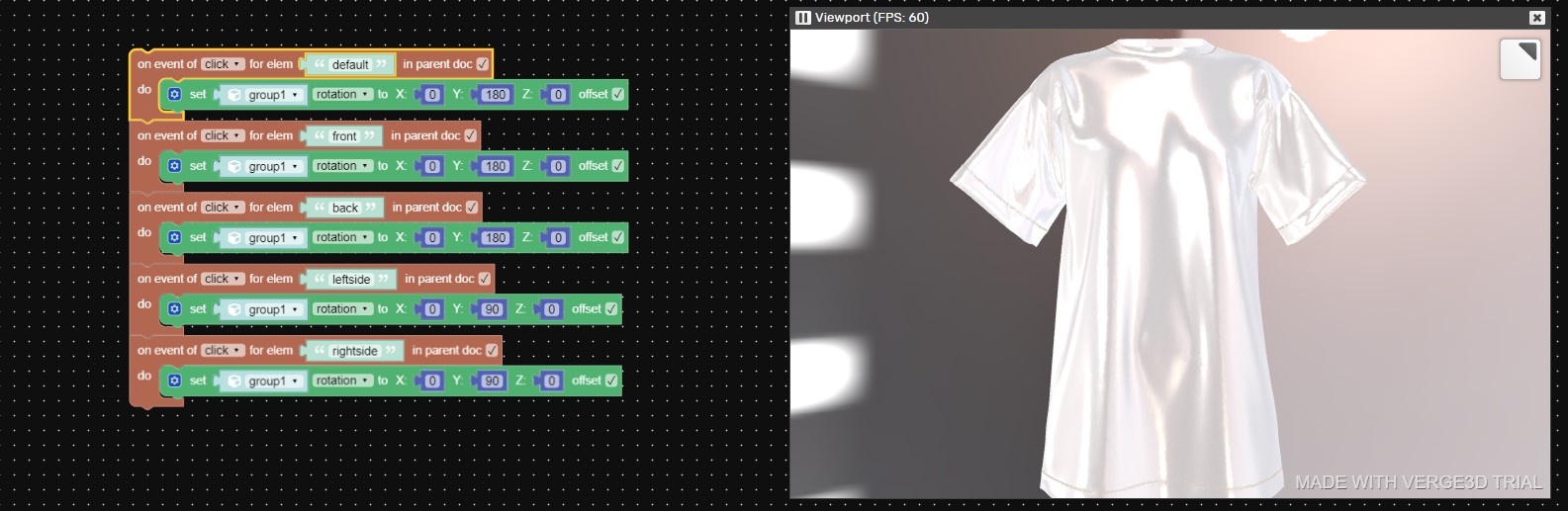

    I want to rotate my 3d object according to the following buttons:
    front
    back
    left side
    right side
    but when I front button 2x times the object will rotate on the backside instead of staying on the front side
    what should I do???

    mjfullente09
    here’s the puzzle, the default should be similar to front
    #60615
    Disable the “offset” option. This option adds rotation to the current rotation. Change angles: front/back – 0/180, right/left – 90/-90
