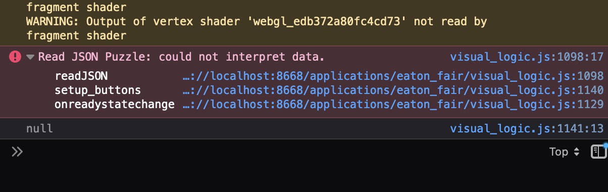

    Hi I installed 4.1 and then my existing project had issues with the the read json puzzle. Attached is the console. I reverted back to 4.0.1 and all worked again.

    Hi!
    Please note that in Verge3d 4.1:
    The load data puzzle can now disable caching of loaded files. Also .json files are automatically converted to dictionary when loaded.
    In version 4.1 there is no need to use “read JSON From” puzzle with the “load data” puzzle, now you should do it this way:
    load-data-puzzle-and-json
    Please check this topic, it is the same issue there.
    Verge3D Developer
    #55304
    Aubrey
    Thanks, that seems to be working. Must of glazed past that bit in the release notes.
