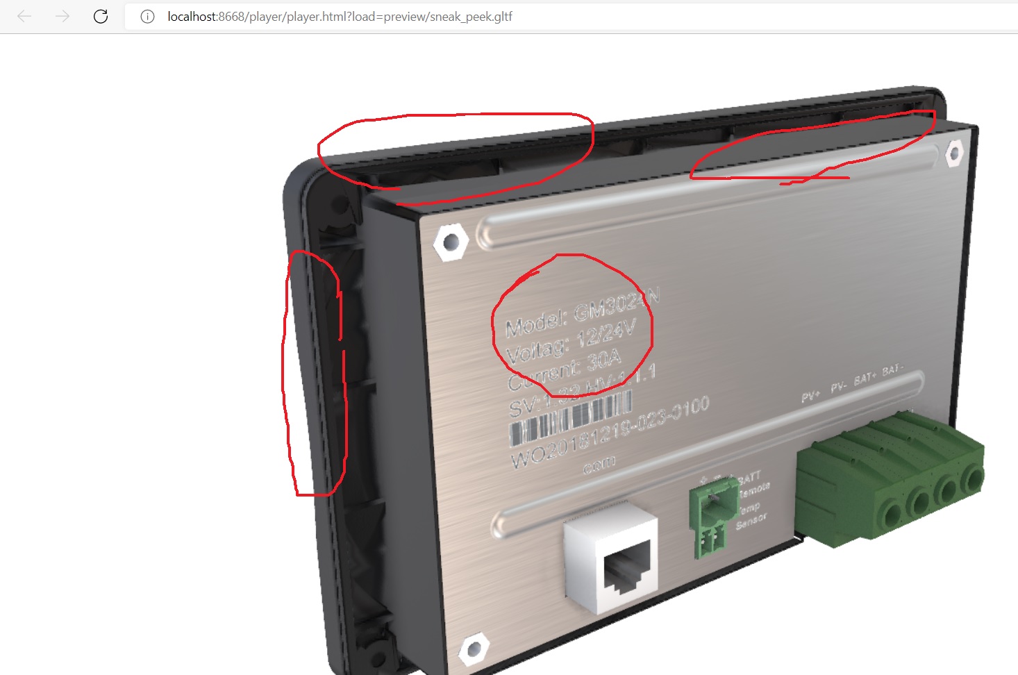

    I had a problem during the final show
    Please see the attached file
    How can this problem be solved?

    Look at this tutorial.
    THis signs made with texture with an alpha channel? If so then you need to add the same color under the alpha channel to solve this. Look at this simple example.
    #51663
    emadd
    fixed
    Excellent. Thank you very much
