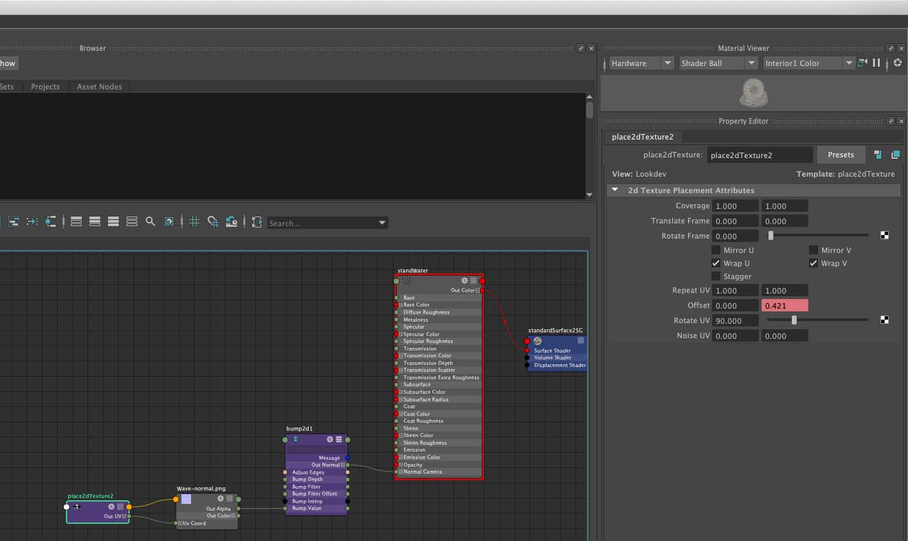

    Greetings,
    I’m looking for a way to animate the UV’s of the texture node in Maya and have it play in Verge3d to make water ripple as an animated normal map.
    I’ve attached an image below.
    I’m sure I saw a new feature in verge3D to do this, but I can’t seem to find it. Any ideas?
    Thanks in advance.
