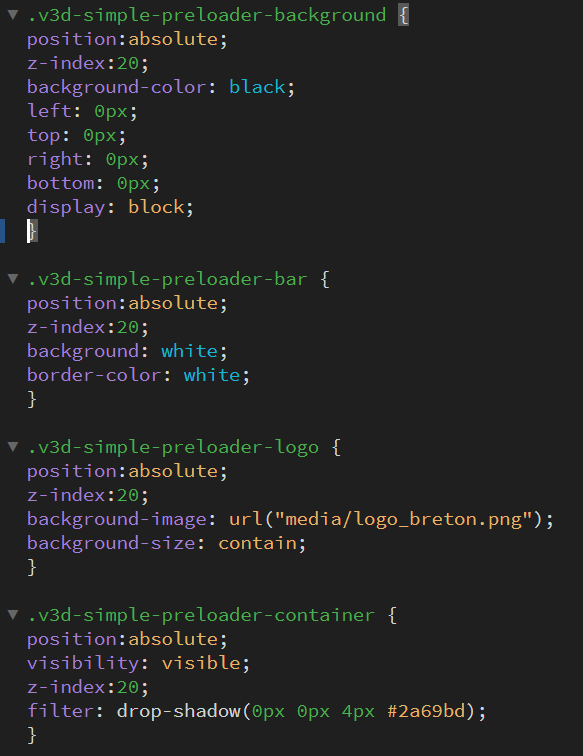

    I tried to use the z-index class putting the preloader levels on top of everything else but it doesn’t work.

    Does this element has position as Absolute, if not then z-index will not work.
    #40408
    ellepucci
    Yes I gave both the div of the video and the .v3d-simple-preloader-background the position:absolute class. :-(

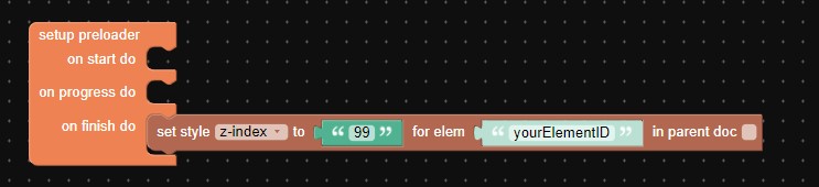

    try setting the z-index in the puzzle rather than in the css, I got weird things going too when using css

    May be things that cover the preloader placed outside the canvas, then you need to place them inside or make your own preloader.
