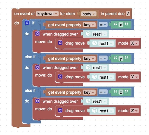

    Hello,
    I tried to specify the direction of dragging for my object with shortcuts für each axis. It works fine the first time, but when after moving it along the x,y and z axis once the shortcuts don’t work anymore and it just moves along the axis I chose last.
    Am I missing something?

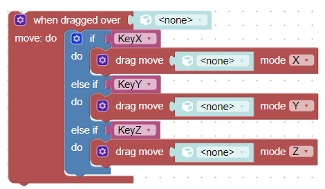

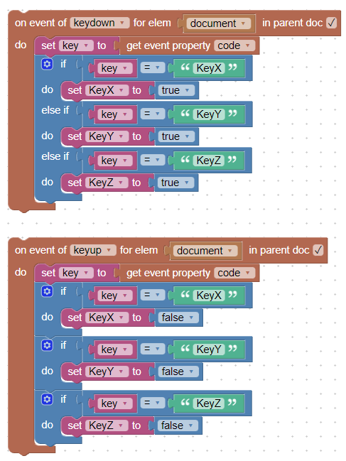

    the problem in your puzzles is that you create the drag event setups every time the user presses the keys. Instead, the puzzles ‘when dragged over’ should be placed outside the ‘keydown’ puzzle. In the ‘keydown’ puzzle, you should set a variable per each direction and then check this variable inside the drag puzzles. You might also use the ‘keyup’ puzzle to unset the variable. Unfortunately I don’t have time to create an example for you but hope this explanation helps.

    Sorry for the late answer but thank you, it’s working.
