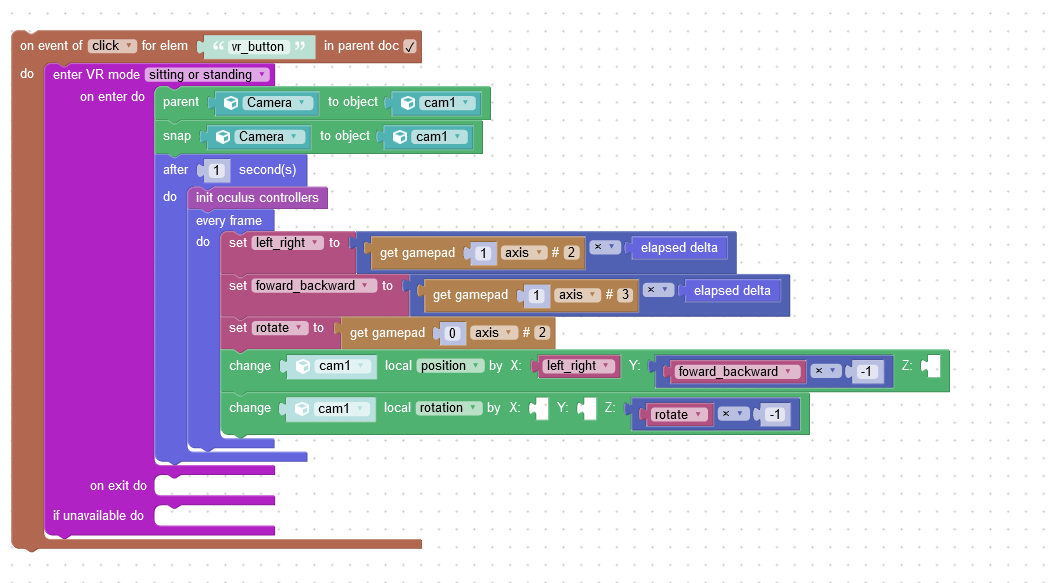

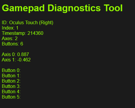

    Hi, I ran the gamepad diagnostic tool to figure out how my oculus quest controllers are mapped in Verge 3D and found that the tool shows the axis id for the right controller as 0 and 1. In my puzzle I have assigned 2 and 3 as the left controller axis and I can use the left controller as expected.
    My problem is that when I assign 0 and 1 as shown, I get nothing.

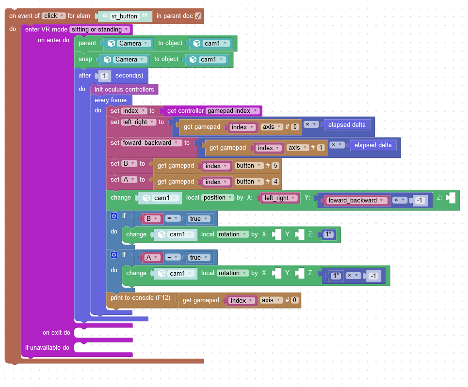

    Update: I removed the index variable in order to differentiate
    Oculus Left Controller Index = 0
    Oculus Right Controller Index = 1
    If I have a variable for index, I will limit myself to one controller and that would be a shame because Oculus Quest has two :)
    All working. Anyone who is into VR like me, this is over 40 hours of work :)
    You can walk forward with the right controller axis and rotate the camera with the left axis.

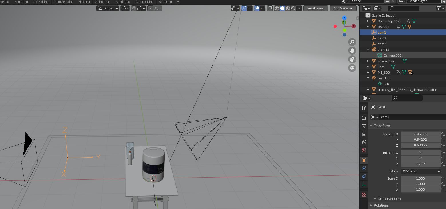

    Dependency here is that your camera in Blender is straight else you will shift in strange angles. My Blender is also attached for anyone interested.
