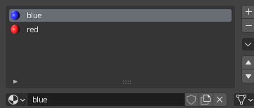

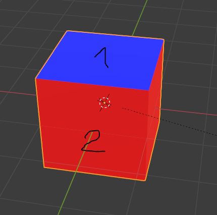

    my situation is:
    I have a cube with two materials on, blue and red.(like on the pictures)
    In blender in the material properties, blue is in slot 1 and red is in slot 2.
    In Verge3D if I us the “get material” puzzle, i only get the “blue” material from slot 1 and I can change it.
    But my question is how I can change the red material from slot 2?
    thanks!
    #39641
    You need to separate cube by material, so there will be only one material on one object.
