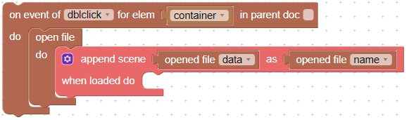

    #60423
    The topic may be closed )))
    And of course, it will work only with .glb files (or with .gltf Embedded). .gltf Separate (.gltf + .bin + textures) cannot be opened all at once :unsure:
