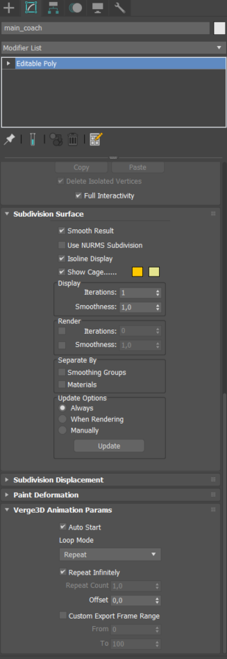

    Can you tell me where that option is in 3ds Max?
    #9542
    They at the bottom of all object’s preferences.
