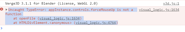

    hi, I have a problem after verisone 3.4 (3.5 and 3.6) the open puzzle gives me an error in cosolle:
    Uncaught TypeError: appInstance.controls.forceMouseUp is not a function
    at openFile (visual_logic.js:1634)
    at HTMLDivElement.<anonymous> (visual_logic.js:4764)
    and does not allow me to upload any file
    #38317
    From your console output it looks like your app is still powered by Verge3D 3.1.
    Please update it as shown here https://www.soft8soft.com/docs/manual/en/introduction/App-Manager.html#Update
    #38343
    it works perfectly. thank you so much

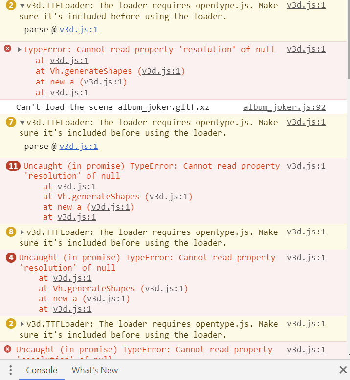

    #38347
    sorry but everything seemed ok but now it gives me this error in console :-(
    #38350
    ok ok solved, I created a new app and found the file and copied to the one I upgraded to
