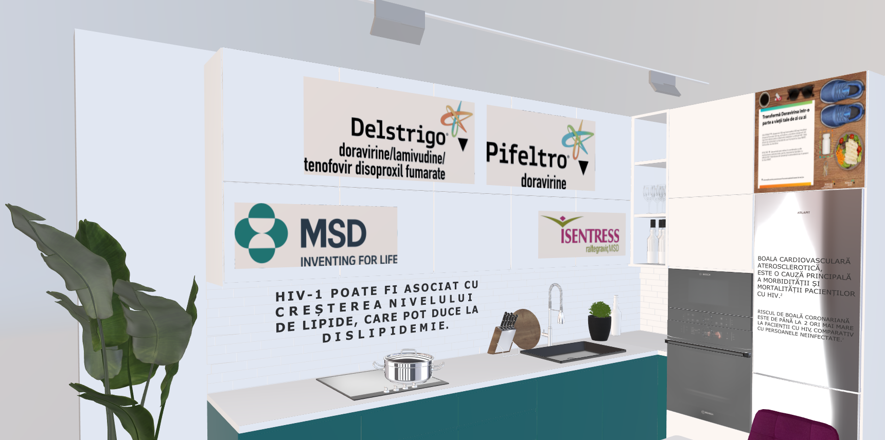

    Greetings ! I have a problem. As in vray and corona, I used physical material color map and opacity but in the rod you do not see transparency. If you can help me with a picture please. Thank you !
    #34460
    You need to set transparency type in material settings. Blend or mask type will work well.
