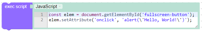

    #66613
    That’s how the “set prop” puzzle should work.
    To Verge3D team:
    elem[attr] = value; is not a good solution…
    #66616
    David Duperron
    As usual, thank you very much! this will be useful for sure… ;)
