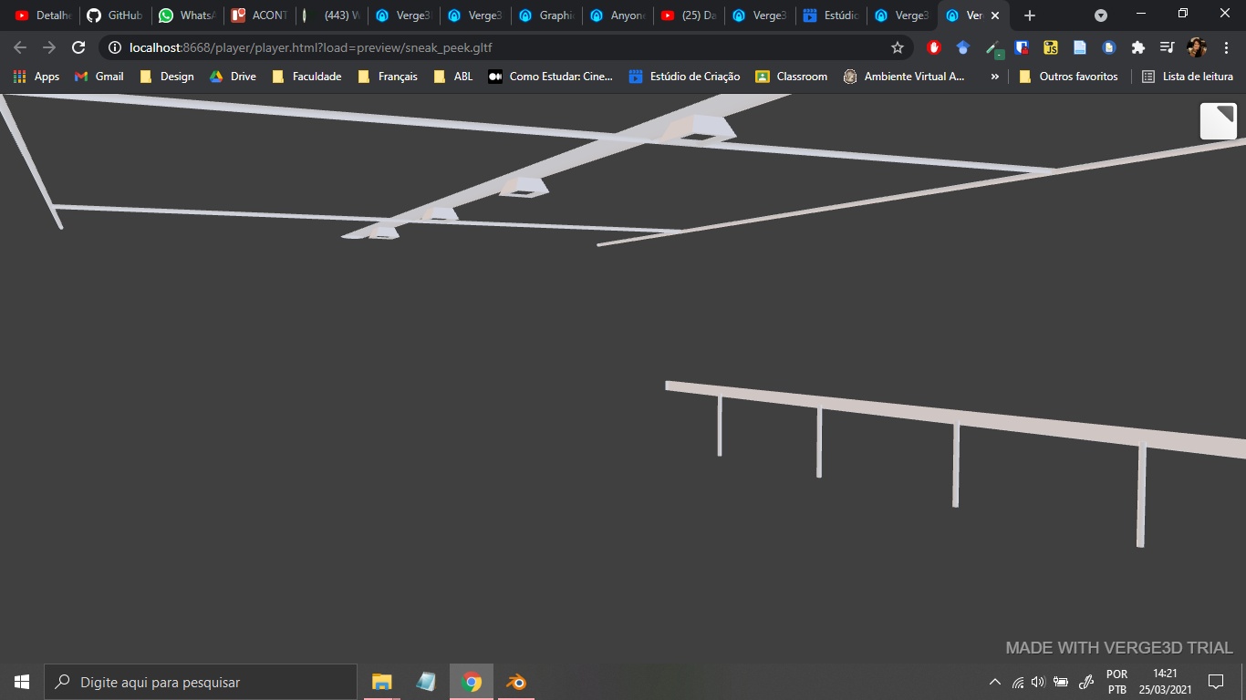

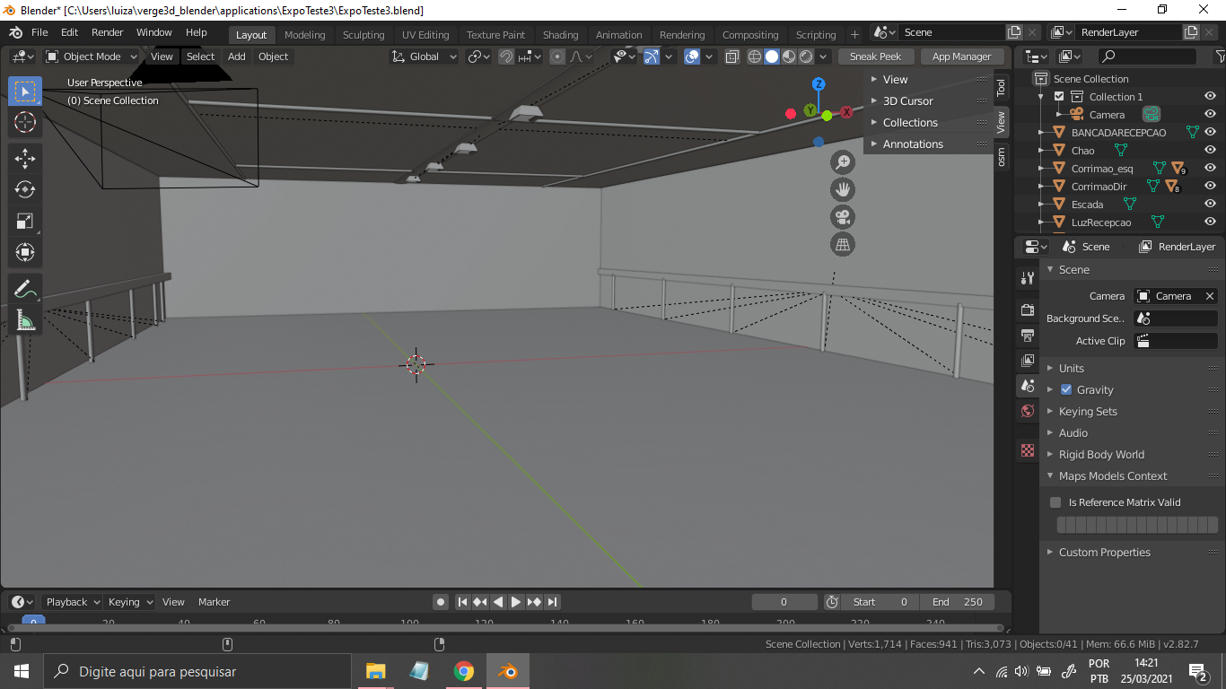

    I’m building an art gallery using blender and verge3d but I’ve been stuck on this issue that I just can’t solve. I built the overall structure of the room but when I click on Sneak peek or acess the app through app manager, most of my room – my walls, my floor and the ceiling – are gone. I don’t know what caused it, I tried removing all the materials and lights but the problem keeps happening. I will attach two screenshots that showcase the issue. Could someone help me? I’m doing this for work and I really need to finish this project.

    Check normals direction, they all must be turned to a camera.
