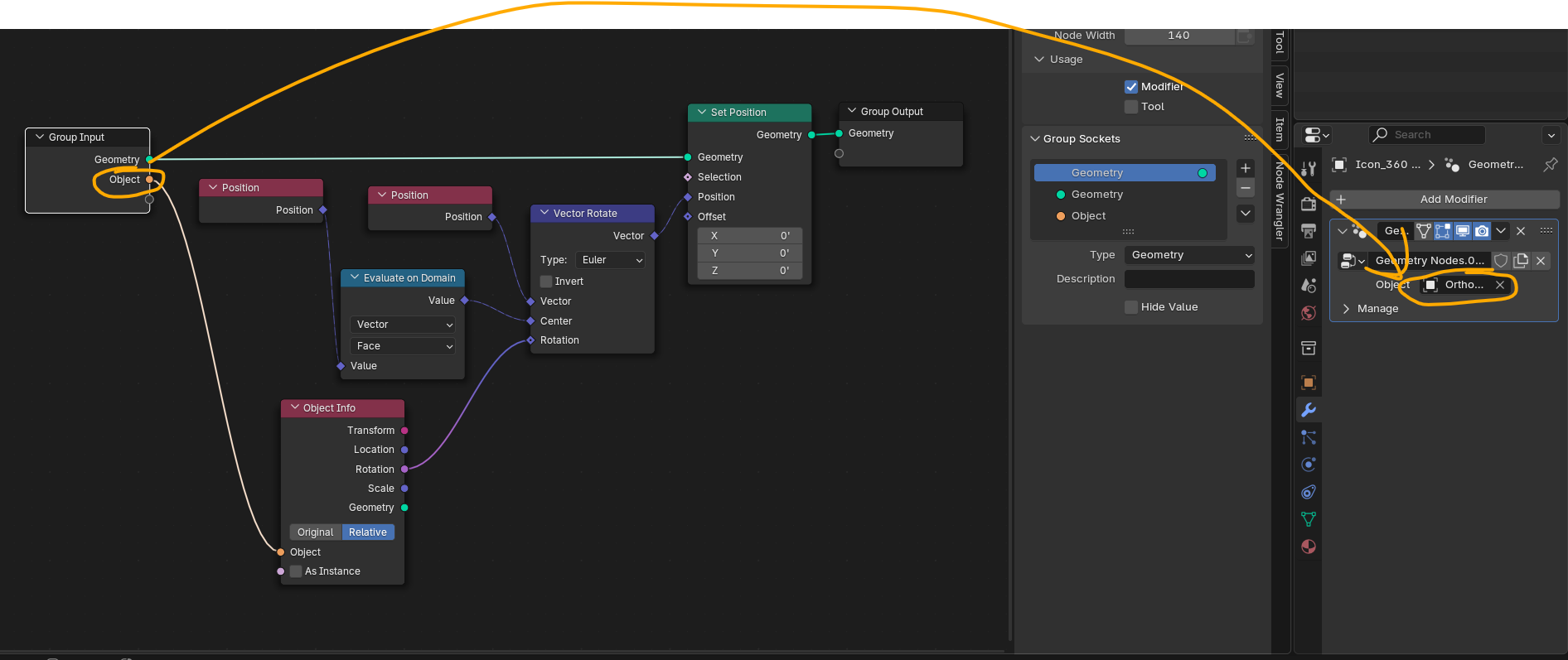

    Good afternoon,
    I have a scene setup in Blender, where I have used geometry nodes to make it so that all of the icons in my scene will always face a camera. However, when I view the scene in the verge3d app viewer, my viewport rotates around my icon sets without them repositioning themselves to face the viewport.
    I’m curious about two things here:
    1) Does Verge3d support the use of geometry nodes in this manner? (I’ve attached a screenshot of my nodes setup for review)
    2) Do I need to program the geometry node functions into the app with puzzles in order for the camera facing nodes to function properly?
    Thanks,
    SB
    #79567
    Geometry nodes are not supported. Use a track to or similar constraint instead to make object face camera
