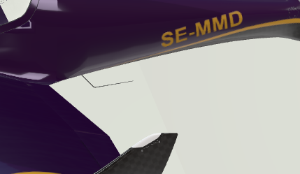

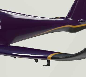

    I have a problem with Decals dissapearing when I rotate the camera and only when the scene is exported to Verge3D on my website. I have tried changing Clip start / End and also unchecked Frustum Culling as it was the only information I could find about it.
    Do you know a soulution?

    the fuselage material should be non-transparent to render your transparent decals properly over that material at any angle.
    #78414
    primaryd1
    Ah alright, thank you for the help!
    #78417
    Blender 4.2 comes with a new material option to switch transparency called “Blend Mode”. By default it is set to “Auto”, which means the exporter looks into the node tree to figure out how to render things. Perhaps you have something connected to Alpha input or maybe the Alpha is less than 1.0… In any case, you can force your material to be rendered as non-transparent by setting “Blend Mode” to “Opaque”.
